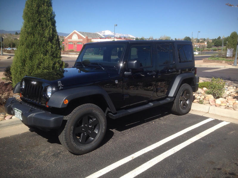

Pull them off, plan on 6+ light coats. 3 to 4 cans of the spray will be enough. I cleaned them with wheel cleaner at the power washer, drove home then wiped them down with denatured alcohol. Laid all 5 out in the driveway on cardboard, taped them off and sprayed them. I think it took me about 4 hours to do the work. I had them mounted and rolling the same day. Be sure NOT to spray the surface that the shoulders of the lug nuts will hit when mounted. It will cause the plasti dip to pull off the area around the lug when you tighten them up. There is a good write here as well...
http://www.wranglerforum.com/f27/pla...ls-128388.html
I am really happy with the result, it has held up much better than I expected, going on 18 months with minimal touch up.

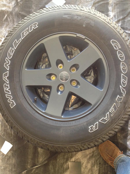

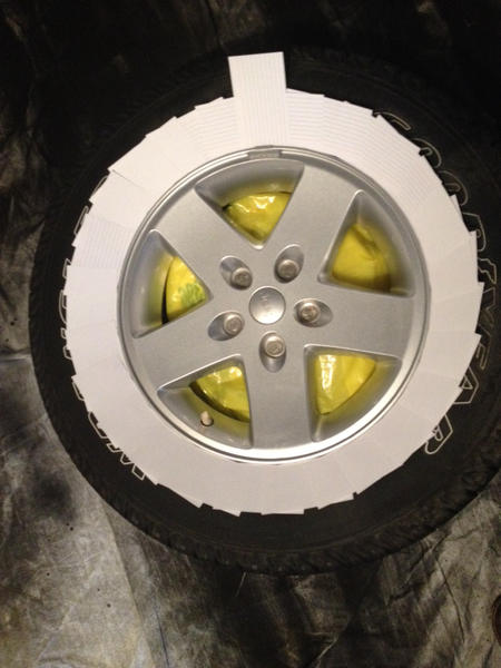

I found it helps to lay quarters over the lug nut holes and the plastidip 'cuts' itself along the line very well. Also using index cards around the rim helped avoid overspray. As mentioned, clean well then wipe clear with alcohol as prep.
(Note that I did four coats of 'dark grey' and two coats of glossifier in these pics)

Both are brilliant ideas! Thanks for that!

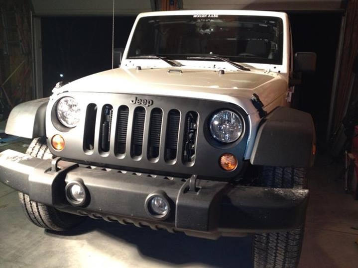

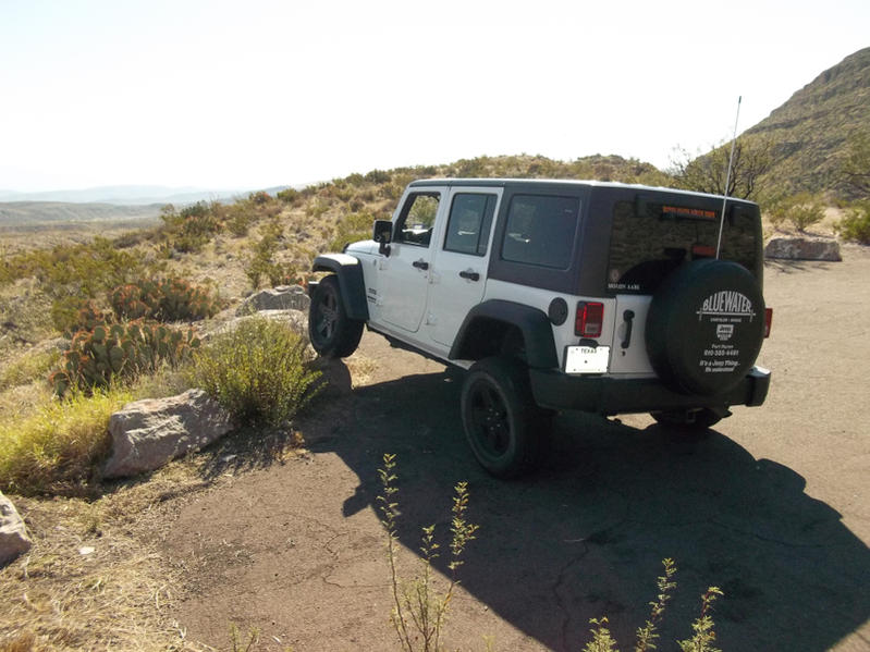

Same here. The couple of runs I saw flattened out nicely. I pulled the wheels and popped out the center caps. If you get any in the lugnut holes you do need to get that out. I used paint thinner and q-tips. I've been off-road several times since applying in July without any issues. My grille needs to be touched up but I kinda expected that.
