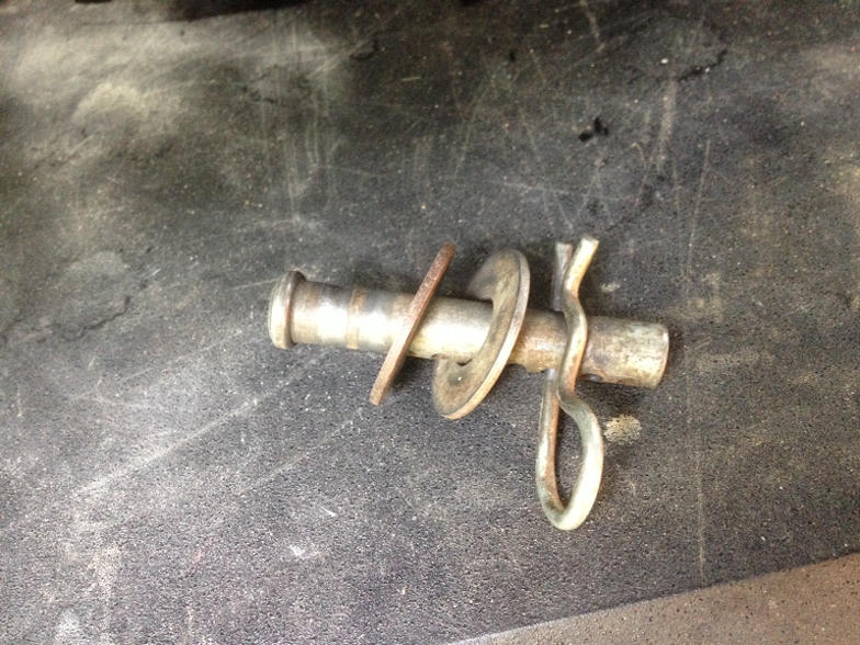

I just use a 2.5" x 7/16" Clevis pin and hitch pin with two 7/16" washers. There's some play in it but it does the job. Running fine like that for years

And about $5 vs 100+
