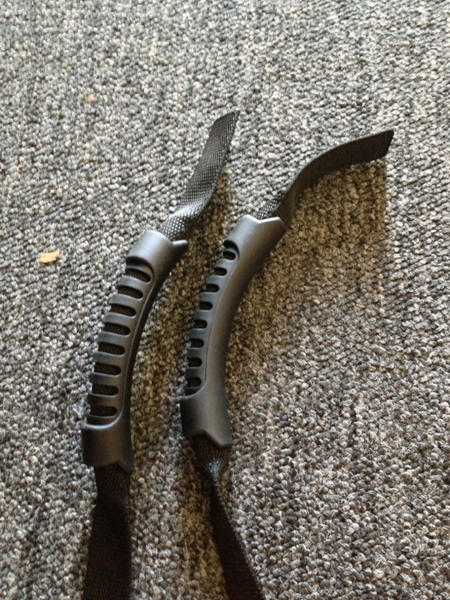

A while back I had read through a post for DIY grab handles. Figured I would post a couple pics from the quick install incase anyone wanted to do the same
All you need is a sharp box cutter and a 10mm socket and a pair of grab handles from CLCBoats. Picked them up for $6.50 each!

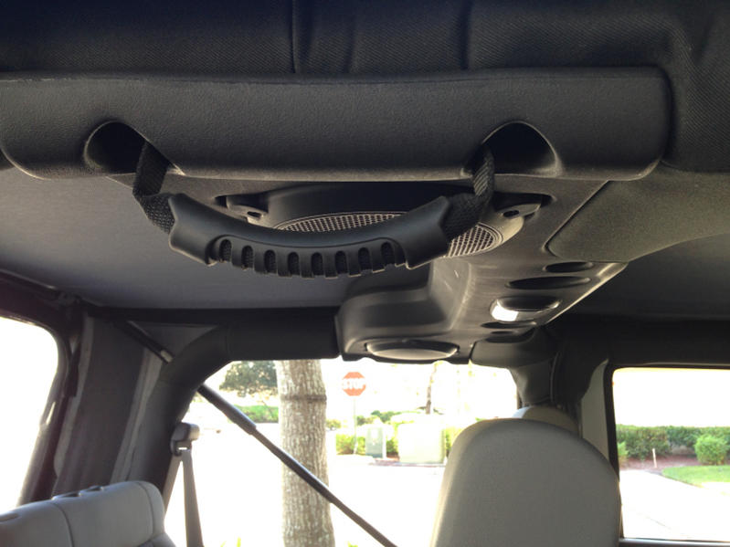

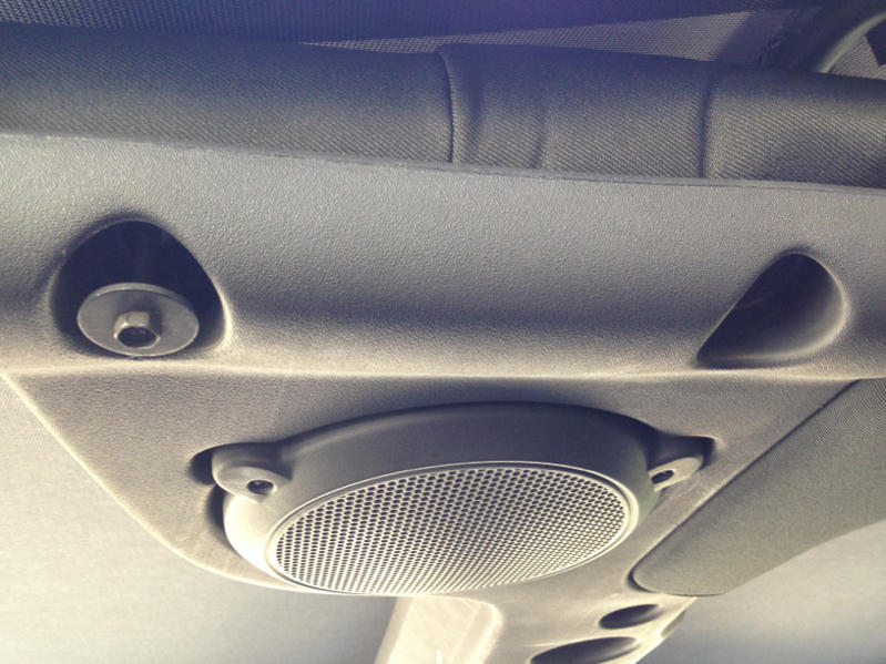

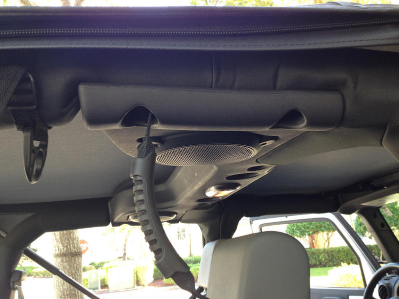

Cut a small slit at the end of each side, unscrew the bolts holding the rear speakers up(one at a time so it doesn't come down) and reinstall.

And that's it!
