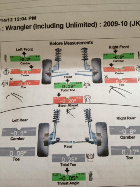

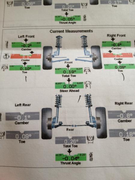

First pic is the before and second is the after. How does it look?
They adjusted the Toe setting. They couldn't adjust the caster or camber.
How do they adjust caster and camber with 'stock' components? They don't!!
Your new ball joints to adjust camber are a $600 'fix'. Your cams are cheap, but have some drawbacks that people need to be aware of before installing. And new arms to adjust the caster will be several hundred dollars.
As noted in the OP's printouts, his caster was low before he paid for the alignment, and it was low after he paid for the alignment. The camber numbers are also the same before and after. Why? Because they can't adjust caster or camber with stock components...
