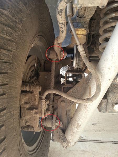

Originally Posted by cctroupe11
If I wanted to run 35x12.5 on some stock rubicon wheels, would I be good on them as well, or need spacers?
Depends a little more on the lift and what it may have done with your rear sway bar links. I am running a Rough Country lift that I cannot run the factory wheels with. I had to install spacers because the rear sway bar links now attach to the outside of the mount on the axle and sway bar. Previous to the lift installation, they attached to the inside of the mount and sway bar. Without the spacers, I could not get the wheels & tires on because the tire made contact with the sway bar link bolt.
