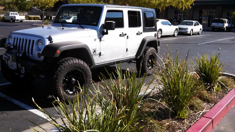

Will i have a teraflex 2.5 coil lift and a 1" teraflex spacers all around for a 3" lift on my 08 jku i all so have a 10k wench and a steel bumper up front a a teraflex tire carrier in the back with 34 inch toyo mt witch is about 115 lb with the rim. I am very happy with the lift and i did add the control arm brackets up front. Although I have never used the Teraflex shocks I do like a stiff ride though.it is my dd as well about 75 miles a day. good luck
