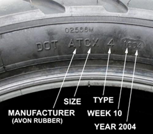

Originally Posted by Randog
I assume to check the age of the tire I'm looking for a manufacture date on the tire? Is there a top secret code to decipher once I find it on the tire?
How to read a tires DOT code.
Attachment 357329
Thanks Kapt, thats helpfull
