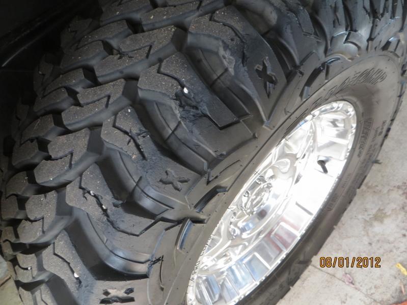

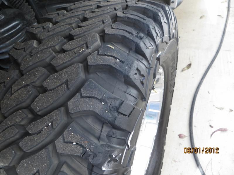

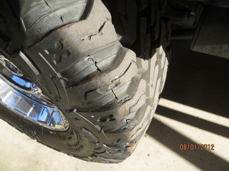

I got talked into these pro Comp Xtreme MT tires. I noticed after the first rocky trial in Big Bear that they stared to "chunk". This is what they look like now after 3 rocky trails, 3 mild dirt trails and 5k as a DD. The 4 Wheel parts guy said its normal; of course. I think not.

I would think not but
how old are the tires?
Attachment 357261
Attachment 357264
Attachment 357265
yup, totally normal. we ran a set and destroyed them in no time. the xtreme mt's use a soft rubber compound which is great for hooking up on the rocks but, the downside is chunking. you should see what they look like after running out on the razor sharp rocks they have out in AZ as opposed to the round and relatively smooth boulders up in big bear

Originally Posted by Audiodogg
It's fairly common, even though you only have 5-6000miles on them. But I would also check the age of the tire and make sure this isn't premature wearing out due to aged tires vs just the typical little pieces that fall off the tire from 4x4ing.
I assume to check the age of the tire I'm looking for a manufacture date on the tire? Is there a top secret code to decipher once I find it on the tire?
Thanks for the heads up on how soft these tires are. If those were my tires I would be disappointed.

Yep, normal, rocks are freaking brutal on tires
