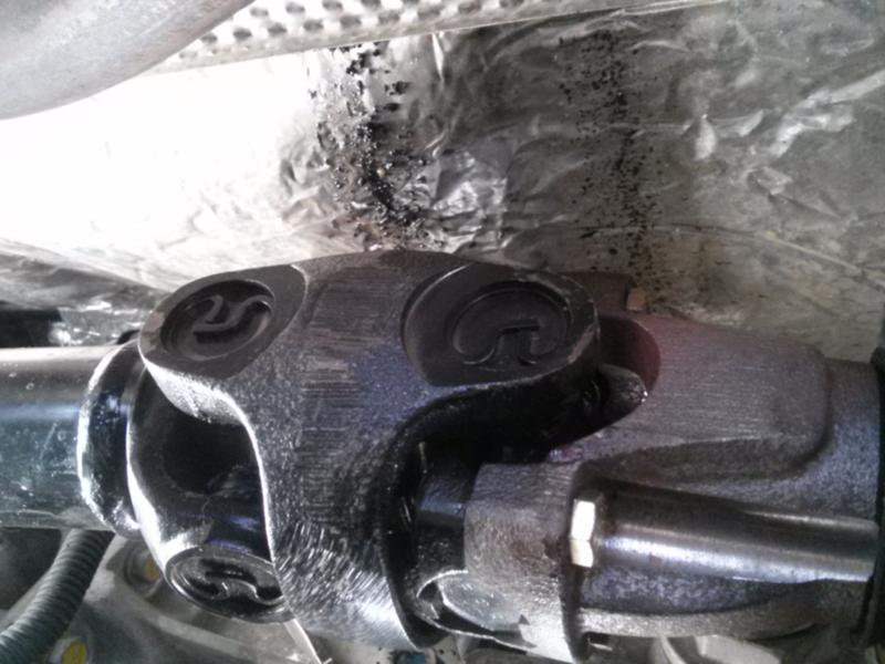

Update: Here are some pics of my front and rear DC ujoints. The heavier band of grease is from my new DS. I have around 3000 miles on new DS's and the thinner is from old. The rear has really not any grease. Just wondering if the bearing sound I described could be the DC ujoint instead of my transfer case bearing.
It is not a constant sound and goes away when I get off the skinny pedal. I am going to remove the front DS Friday(if not raining) and clean up the slung grease, remove the front transfer case flange nut, apply more red locktite and retourqe to 135 ft. lbs to be sure it is tight and see what happens.
I, just want to know what you think?
