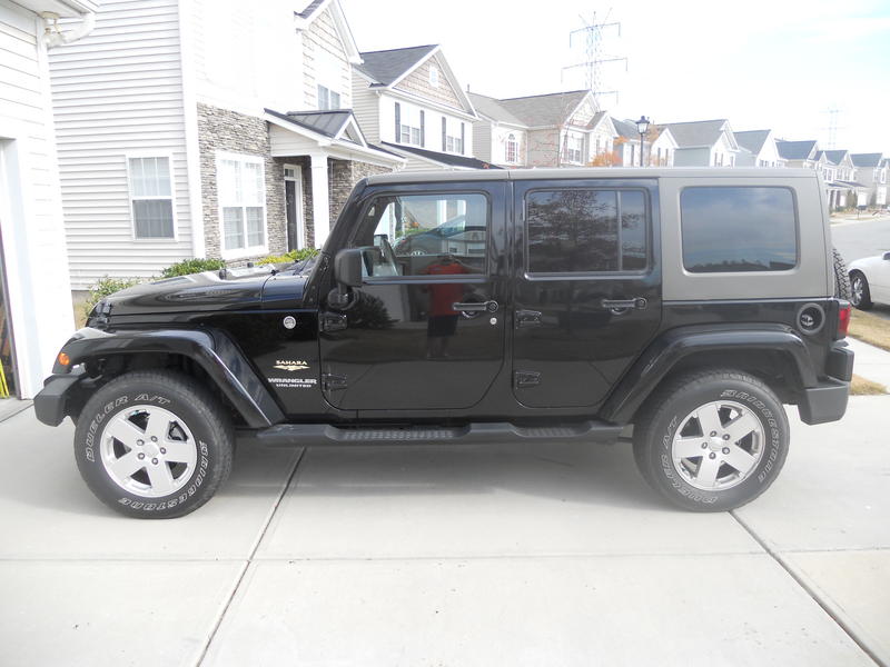

Here is mine with the teraflex leveling kit and Duratrac's (275 70 18)
Before
With Duratrac's and no leveling kit
With leveling kit

Originally Posted by dstock
Here's another TF leveling kit and 33" Duratrac:
Looking at putting the same combo on my Jeep.
What are your thoughts... ride etc... How did the leveling kits and duratracs effect your gas mileage?
Old Nov 22, 2010 | 06:54 PM
dstock's Avatar
Joined: Dec 2009
Posts: 439
From: Torrance, CA
I didn't notice any change in ride other than it feels a bit more planted. You will have slight tire rub on swaybar at full lock with stock rims and no spacers. I just adjusted my steering stops with a couple washers and no rub. I have an auto and lost prob a mile per gallon city. I am still able to use overdrive on the freeway, but it's right on the edge of acceptable in the 70-75mph range.
Overall, love them and are happy I got the Duratracs.
Ultimately, I will go the route triplejeep went with an OME 2 " lift as I will be adding bumpers/winch, etc.
It is after all, a slippery slope!
