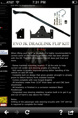

This has got to be it! I have a TF stabilizer and the stabilizer relocation bracket. My draglink and trackbar are no where near parallel. I take it that that is the culprit behind it all. If I hit even the smallest pothole my steering wheel goes super nuts untill I pull over and stop. Trackbar is torqued and bolt holes arnt ovaled out. Will the EVO draglink flip kit do the job? It has new trackbar brackets and a new draglink to flip for jeeps 3"+ in lift(thats me!). I haven't picked up my jeep from the dealer yet, so I can't get any pictures of the front end yet. Other than the SS, I'm completely stock.

What do you think of the EVO kit I posted about? Is that what I need?
