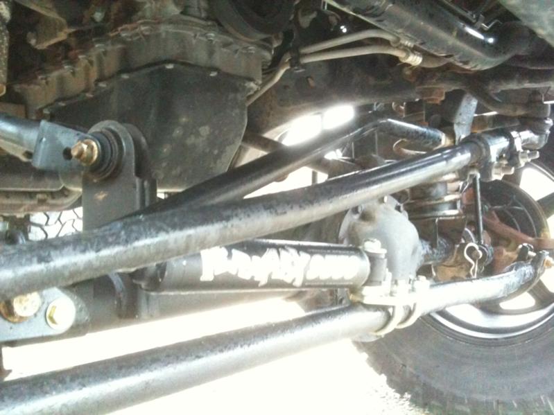

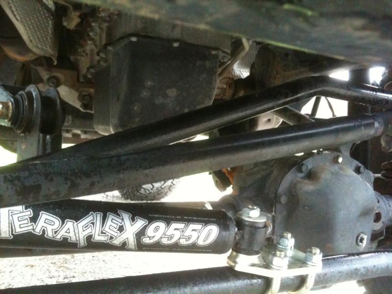

Ok I got my jeep back and toon some pics. You can see that they arnt parallel at all. The trackbar needs to be raised on the axel side and lowered on the frame side. And the draglink flipover would be a bonus, not sure how that helps. I think the EVO kit would be the best.

Can't tell from looking at the bent bars from the side.
Take a pic from straight on like in the vid, mark the mounting holes and connect them.

I can't! I tried to take one straight on but the picture isn't panoramic enough to get it all and the bumper is in the way for me to stand back. I just ordered the EVO draglink flip kit with trackbar relo brackets. Not bad for $300.
- you can see that the bars arnt parallel. With out a stabilizer(one in picture is blown) the jeep is just about un-driveable with the amount of bumpsteer I get, only when I hit bumps tho. I hope that EVO kit fixes it.

#1600440 Flip Drag Link Kit that was designed for that 4" kit. Looks like you have a Gen1 TeraFlex Trackbar. I wonder really consider upgrading that also to the newer style that TeraFlex offers. I can get you a exchange credit here for it. Pm me if your interested.
