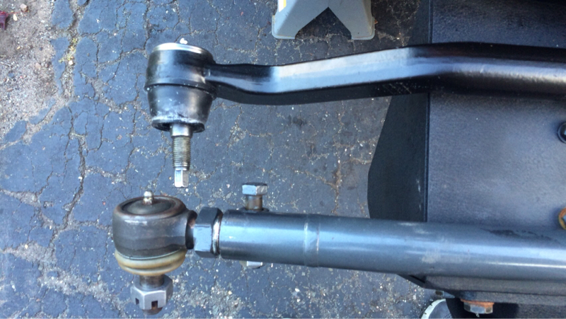

Originally Posted by DunnyBunny
What ends do those use though?
Forged fully sealed w/ 30mm ballstuds. Look like stock but massive. Theres also a no flop feature built in to the knuckle joint.

Originally Posted by kjeeper10
Forged fully sealed w/ 30mm ballstuds. Look like stock but massive. Theres also a no flop feature built in to the knuckle joint. yeti and Synergy Video Link: http://youtu.be/v0NH5X7iLEw
2 tons the Yeti is tested at here ^^
