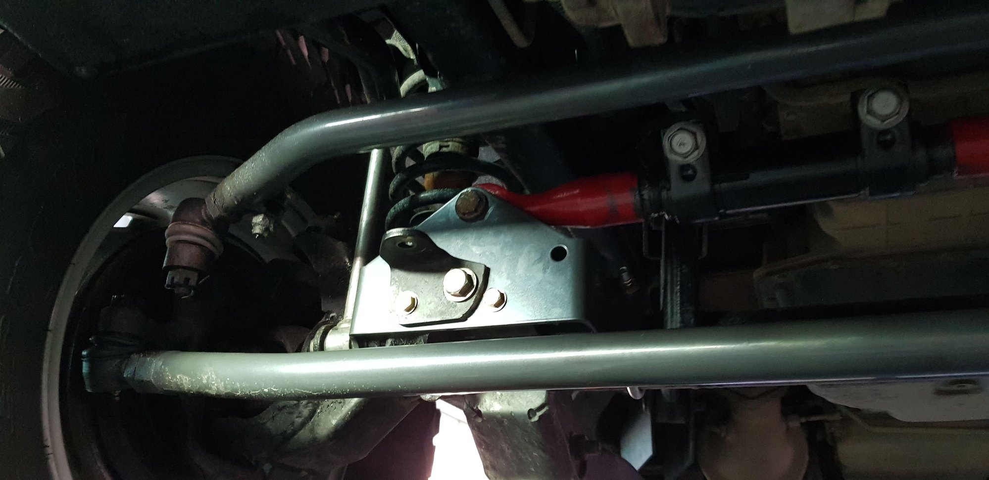

Old Dec 2, 2019 | 07:02 AM
  #37
liondor1969's Avatar
Joined: Nov 2019
Posts: 32
From: AIUD
Hallo
I made all thin new kit from Synergy install,i made aligniament to a garage..but the light ASR is com ON.. ( The steering damper is also montet ..but not in this picture )
Old Dec 2, 2019 | 08:38 AM
  #38
TheDirtman's Avatar
Posts: 6,222
Likes: 376
From: Southwest Reno, NV
Your steering links have nothing to do with the ABS light. You have speed sensors on each axle end. Check these sensors for debris in the tone rings and the wires to make sure they are in tact.
