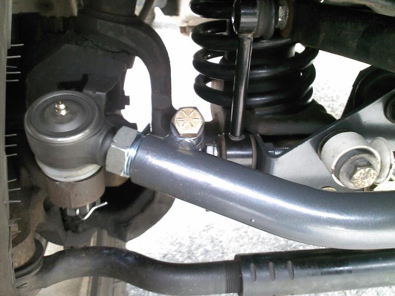

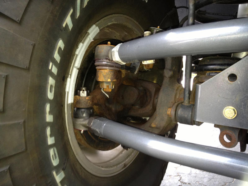

I just helped a friend install the Synergy draglink flip and track bar relocation bracket on his Jeep yesterday. The Synergy componets are beefy. The install wasn't hard, the most difficult part was gettting the stock draglink to release from the pitman arm. One issue we did run into was his BDS swaybar disconnects wouldn't work with the track bar relocation bracket, there was not enough room between the stock tab and the bracket to get them on and off and they were to long to mount on the upper hole on the bracket. We ended up putting a set of stock links on for now.
ID:	429082   Click image for larger version
