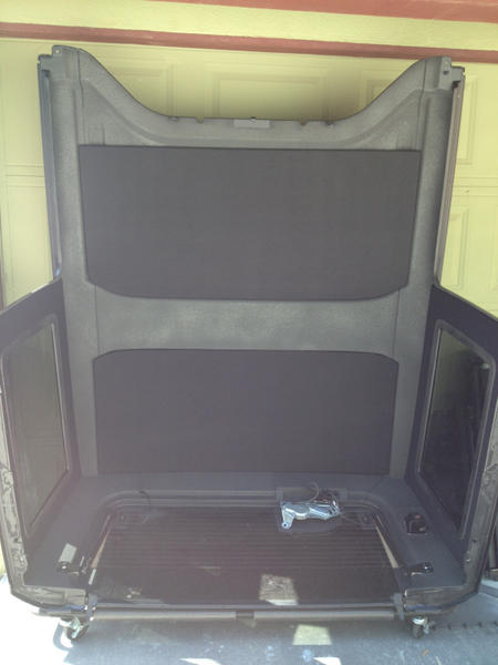

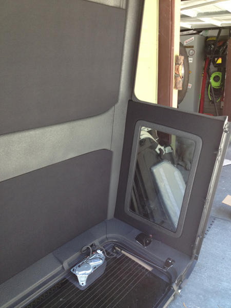

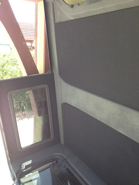

Hard top lizard skinned and hot head liners installed!

Very nice. I hope to do this in the next month or so. You are doing sound deadner only correct? How much have you used in total?

Ty!! I did 2 coats sound control and 2 coats ceramic barrier and finished with a coat of urethane.
So far I have used almost 4 gallons of each product for the vehicle and top. It goes pretty fast. Need to get more to complete the doors.
