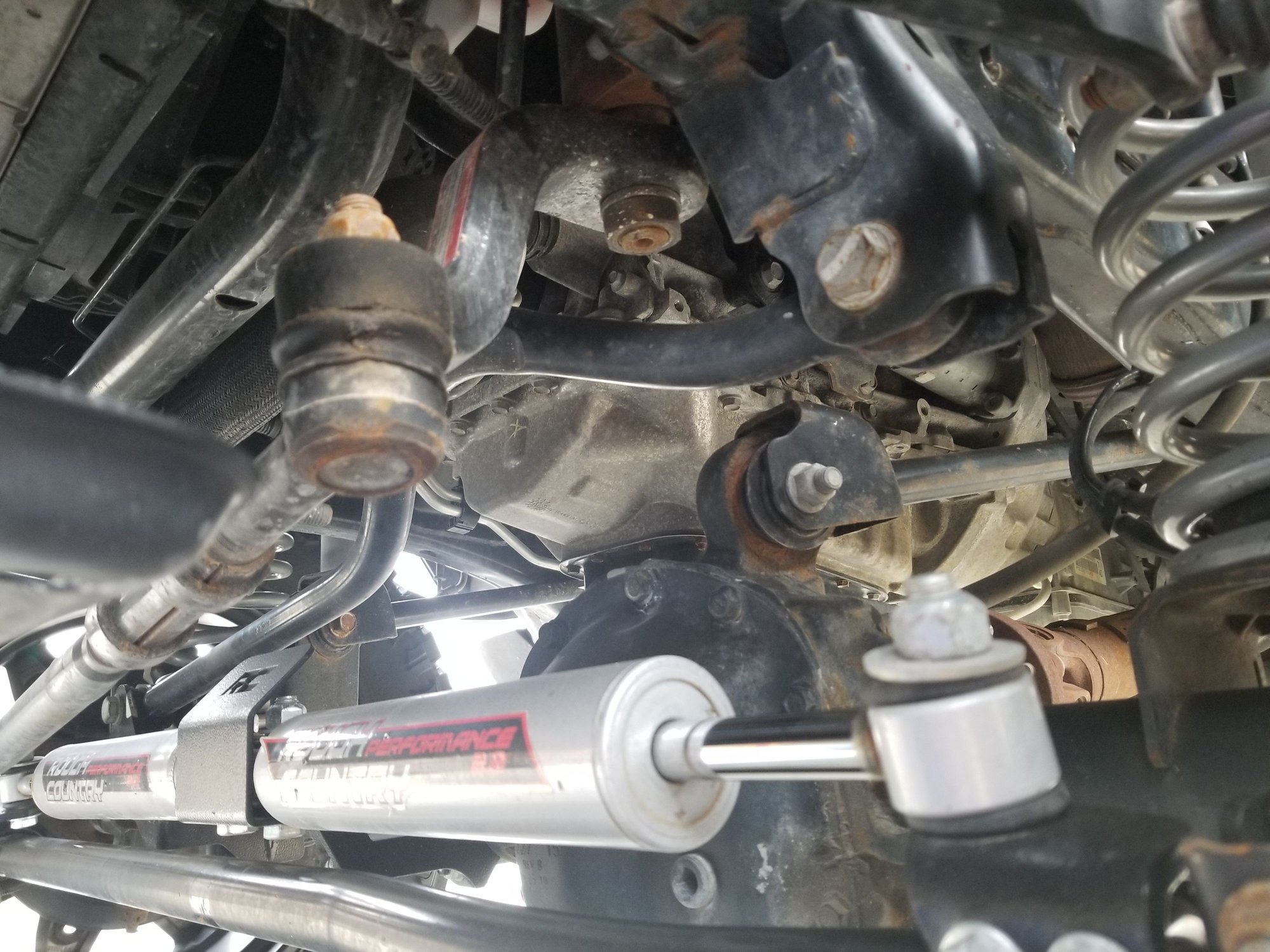

Maybe you guys can see something obvious with these, I haven't been able to yet.
From that angle, it looks like a drop pitman, but ...
What does the other end of the trackbar look like. Pic 1 and 13 show the factory bracket, and the installed raised bracket.

So anyway, what we are looking at here is flattening the angle of both the trackbar and draglink. The preferred method is to raise both from the axle. (axle side trackbar bracket, and moving the axle end of the draglink to the top of the knuckle.)
The cheap method is to lower the frame side with a drop pitman, and either lower the trackbar from the frame or raise and move in from the axle. This method isn't as well recieved, with comments that it messes up the 'planes they travel in', or some similar phrase.

You might double check the torque on the pitman arm bolt. (I don't know the answer to how it would drive if that bolt was loose, just a thought since they did swap out that part.)
It's hard to tell from the pics, but it looks like the Track Bar may be interfering with something. Possibly the SS? Hard to tell from the angle of the pics, but I noticed some scrapes on that TB, which means there may be some other part that has scrapes on it as well that it rubs against during different steering and suspension flex situations.
