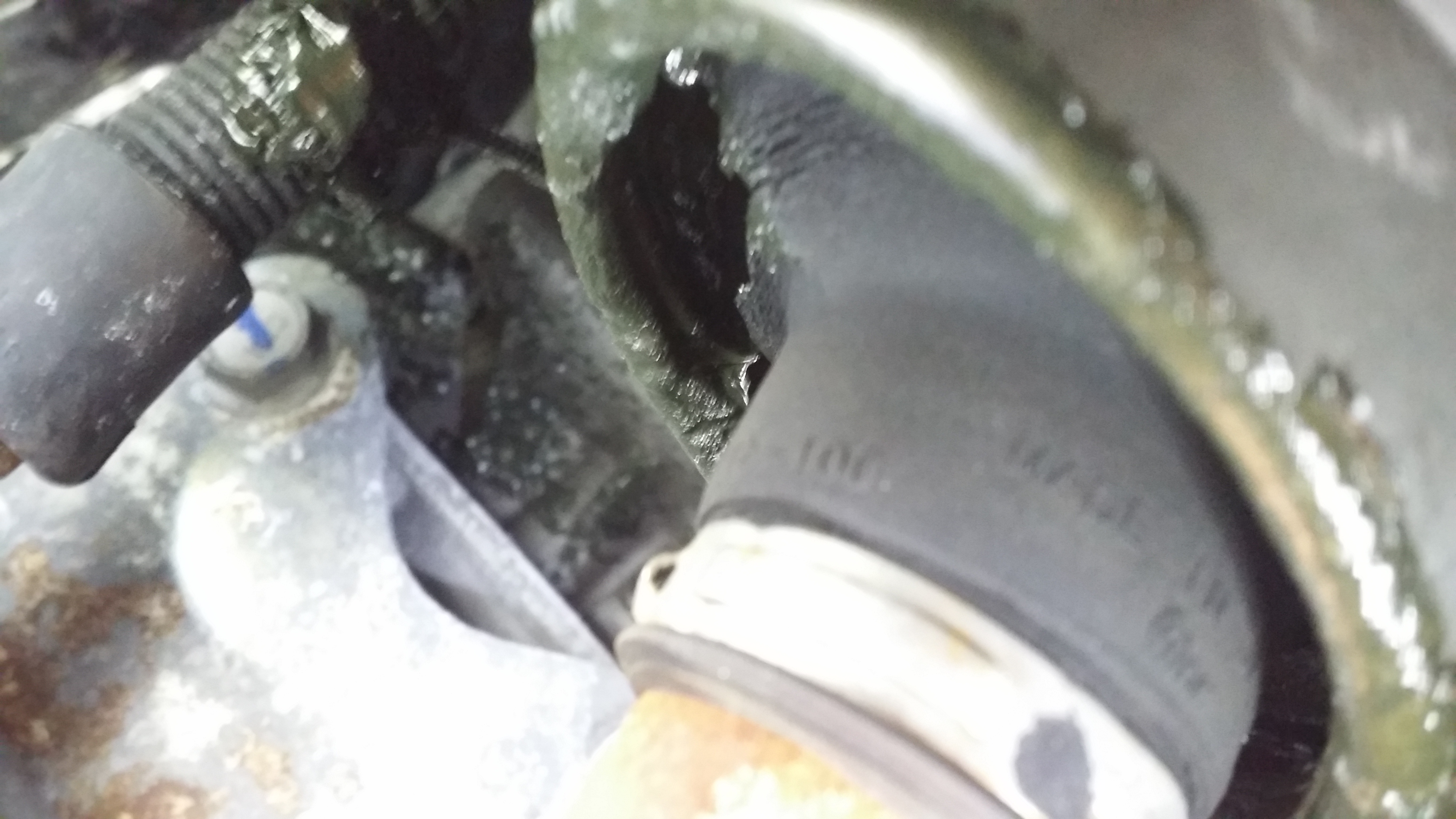

So being the idiot that I am I forgot I was in 4hi and went to drive a few miles home. First turn was a uturn and obviously noticed immediately. Went to go shift back into 2wd but shifter was loose and knew immediately that the grommet on the underside had failed. So was only 3 miles from home so just drove it home making sure I didn't cut any tight turns figuring it was fine. Gave time for the car to cool down (wiring up my cb radio while I waited).
Then as it was getting dark I got underneath and went to fix the grommet issue. Quicky felt a bunch of grease and knew something was wrong. There was grease sprayed everywhere, the underside of the tub, on the transfer case etc. See below pic of where it seemed to blow out at the CV joint. So I am going to go ahead and replace the front drive shaft. With that I am curious what is a good replacement? OEM is around $750 but seems there are other options such as Spicer, Tom Woods that run around $500. I do have a 3.5" lift. Currently looking at a Rubicon Express drive shaft as well from 4wp as I can get one in relatively quickly so I won't have to drive around too much without a front drive shaft.
Thanks.....oh and yes I was able to put the jeep in neutral and put it back in 2wd as it rolled.

Teraflex makes a high-angle cv replacement joint that you can slap on your stock driveshaft, if you want to stay with it. (Or I think Crown makes a repair type kit, which will just fail like the stock one.)
If you want to go with a thinner aftermarket shaft, they all seem to be about the same quality, the difference is which joints you choose and if you want to do the flange/yolk swap or get an adapter. Lot of people like spicer joints. I have been running a Woods front shaft for about 6 years or so, no issues. Though I did swap to sealed joints a while back, as I am getting old and lazy and was getting annoyed with dropping the shaft to grease all the zerks...
