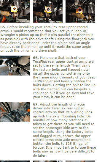

Old Jul 25, 2011 | 09:43 PM
mkjeep's Avatar
Posts: 15,665
From: Hammond Louisiana
Name:	setting rear uppers.PNG
Excerpt from Tera 4 in lift install, arms are set the same way for the rear. You can look at alot of the project jk installations and apply the basics of them to other lifts.

Originally Posted by mkjeep
Attachment 186253.............
