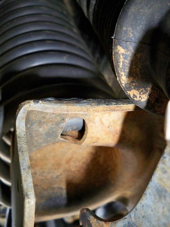

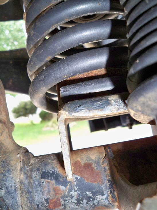

My drivers side front spring spinning out of perch - does anyone sell a strap or pre fab part to weld on and pin it down?

sounds like your shocks are a bit on the long side and your coil is unseating at a full droop. you might be able to fab up a spring retainer like the old tj's had. all you need is something like a small conduit clamp and a self tapping bolt and you're golden.
thanks WOL - great idea!
