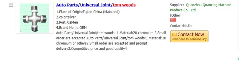

.....Click image for larger version
Name:	tw china.jpg
I'm guessin this is where they come from?

just google "u-joints origin tom woods"
guess what,that china manf specializes in u-bolts, u-joints and bicycle parts too...
Damn man, I hope Alibaba and this Chinese manufacturing company know they are disclosing confidential and proprietary information about the origin of manufacturing of Woods joints. I thought that information was kept in a vault with the formula for coca-cola and Jimmy Hoffa's bones.
