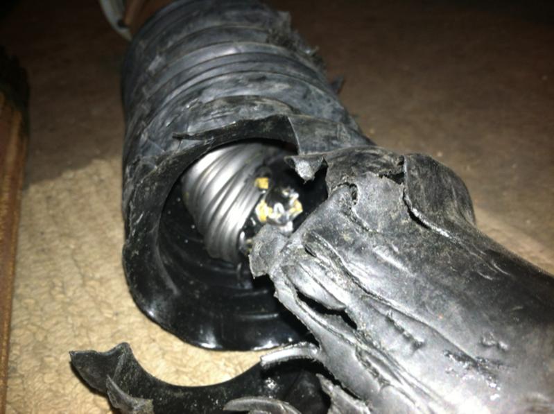

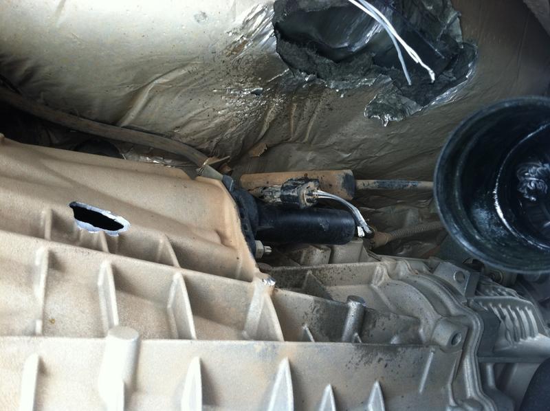

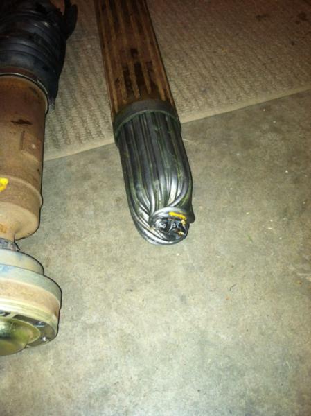

I broke my front shaft after getting stuck in the snow this year. Stock height. I don't think that you will have a problem, but I would disagree with the guy who said just drive it till you break it. I was spinning when mine broke and the front half smacked into my tranny and put a hole in the bell housing...expensive, annoying, and outrageously frustrating. For the price of my repair, and I got away pretty easy on the price, you could upgrade both shafts and not worry about it. The problem is the slip yokes
