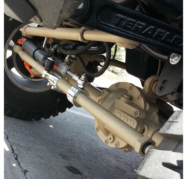

Well, that's pretty much calling me a liar all the way around. This is why I hate posting half the time. Ram assist caused me massive headaches on my build and was massively over assisted. I also had one of the very first PSC kits for a JK and it was not ready to work with a 6spd. They didn't have the correct brackets for anything, all had to be custom fabbed. The stabilizer might be overkill, but it takes the edge off, it was utterly and completely twitchy before this solution.
Name:	steering stabilizer2.jpg

You owe a picture of your hydro assist and why you think what I stated is wrong.

The complete front-end setup on my rig: Reid Knuckles, Dynatrac Ball Joints, RCV axles, Currie CurrectLync steering kit, TeraFlex Monster Track Bar, TeraFlex Dual-Rate sway bar, PSC Trail Assist steering (2008 version), TeraFlex stabilizer, TeraFlex Big Brake Kit, TeraFlex 6" lift spring for JKU, JKS ACOS Pro, Full Traction Long Arm Kit, Elka shocks, ARB locker, 4.88 gears, JE Reel 1350 drive shaft, AEV Pintlers, SpiderTraxx 1.5" spacers, Goodyear MTR 37s. Before steering stabilizer--even with this entire list of mods... twitchy. After, now feels very close to stock.
Attachment 453523
Wow pretty strange system. Glad it works for you thou.
