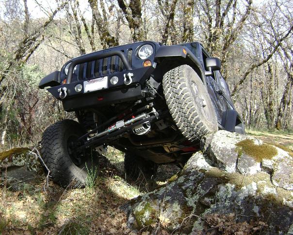

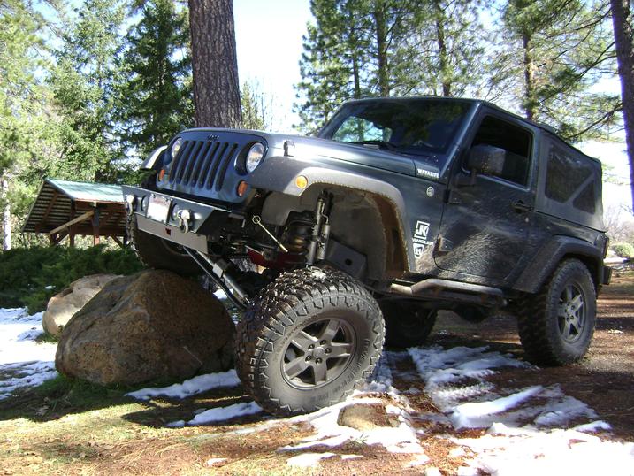

If it was available at the time, I would have loved to buy the new Fox ATS. I love my dual Bilsteins, no dominant pull to either side.
