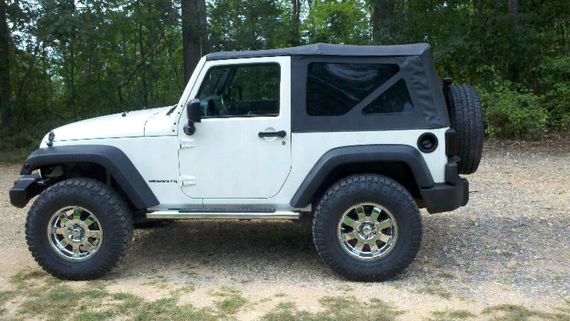

I have a 2&1/2 inch lift and 315/70/17 duratracs. And my wheels r 4.5 back spacing and either 8 or 8.5 wide. And I have no problems.

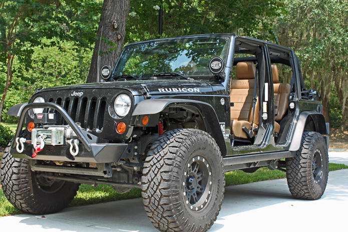

Yep. This pic was when I still had a 2" BB. 16X8" wheels with 4.5" backspacing and 34.8" Duratracs.
Name:	hella covers.jpg
