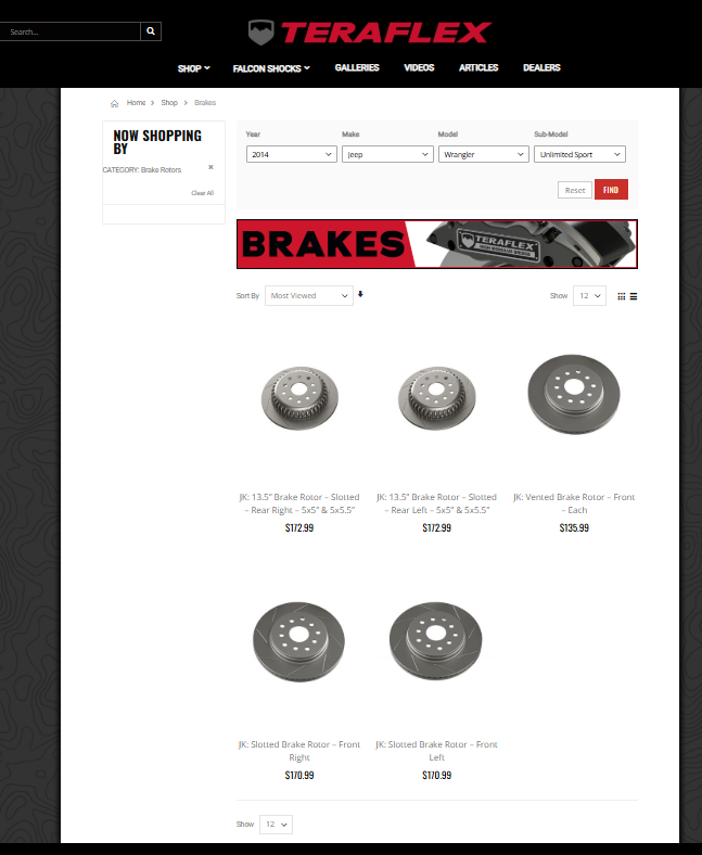

I have to admit some confusion on the TF rotors. not sure what the difference between these two model numbers are, outside of the one that has painted inner -
Especially since on their own website TF doesn't even list that second one -
I purchased the first set of rotors last time and they were pretty much a swap for the Crown rotors I had previously (I needed a 5x5.5 bolt pattern for a hub conversion but still using crown calipers and brackets). i had to pay to have the inner bore machined out for my hubs which added a good bit to the cost, and sucked.
Take a close look at where the DT pads land on that rotor. Compare the diameter of the DT rotors to the TF or Crown and judge the spacing how close the DT caliper brackets place the pad on the current rotor and judge if you have enough space to play with. I'd imagine you're likely ok but i'd want the security of being able to return the new rotors if you get them in hand and that doesn't appear to be the case.
