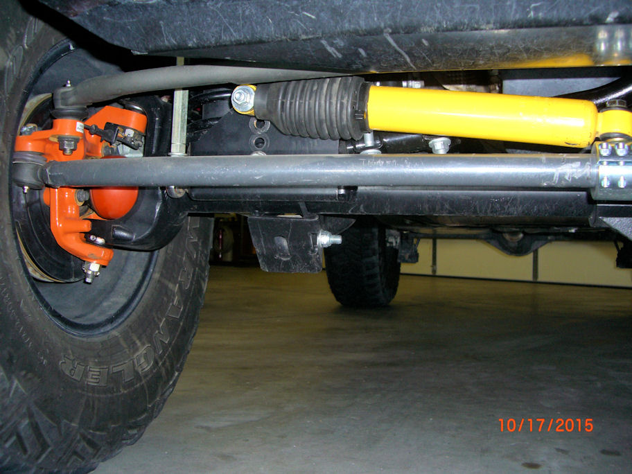

Well, I don't think it, I know it. You have two points that connect to the axle and travel on an arc. As the axle drops, it gets pulled to the driver side because of the arc the track bar travels. If they are not aligned, that means the drag link is traveling on a different arc. Track bar wins and forces movement in the drag link. Basically, it is steering when you aren't asking it to. On a smooth road, not that big of a deal. Get the suspension moving and you will have bump steer. In addition, you will have premature wear of those parts as they are constantly fighting each other.
Not to further complicate this, but from the factory, the angles are slightly different as the drag link and TB are different lengths. They were engineered to intersect at the perfect point on the arc. You don't have that luxury. In addition, there is very little angle stock - the bars are almost parallel to the ground. Therefore, there is very little movement to the side. Think of movement to the side as exponential as you get deeper into the arc. I'd guess your track bar is on a pretty steep angle.

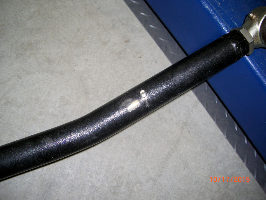

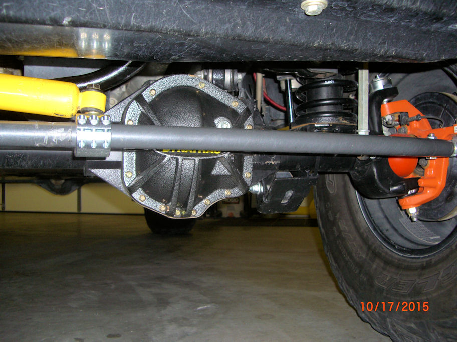

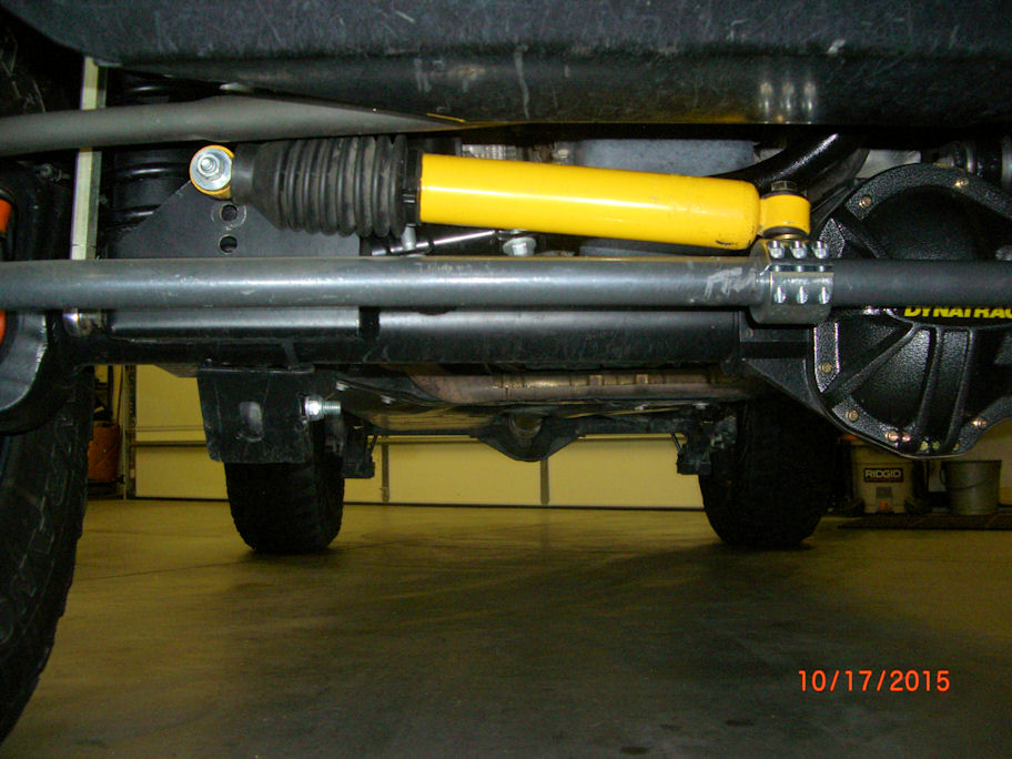

Here are some photos. I was not aware of any known issues with perch angles with Dynatrac axles. In retrospect, I think i'd have been better off with the Currie axle. If it's a known issue, I would think Northridge would check the axles for any issues prior to shipping. I did contact Dynatrac, and their solution was an offer to send me a perch so that I could cut off one and weld the replacement properly in its place. That would be at the limits of my skill level, and I declined.
You can see in the photos where I had connected the Terraflex trackbar to see where I could place it without having it contact other parts. Using the top two holes I had contact with the pitman arm nut, but in the lowest hole I have no problems. I ended up using the top hole for the steering damper. You can see where the Clayton trackbar was contacting the diff. The only issue I've notice with the setup is that if I go through a big dip in the road at highway speeds I get a rocking motion that I attribute to the offset of the front springs due to the perches.
