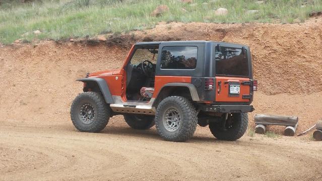

Theres the old gal... 2010 with a 6 speed. Shall i go 4.88 with 37s? I have been running 35s with the stock 3.73 and have gotten used to it, although, i really wouldnt mind having some more pep.

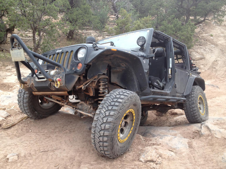

I replaced my Dana 30 last year on my 09 JKU auto this is what I went with ..... PR44, RCV's, Reid Knuckles, Dynatrac ball joints, ARB air locker, Yukon 5.13 gears.... Rolling on 37" MTR's on Mickey Thompson wheels.... Good luck
