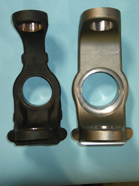

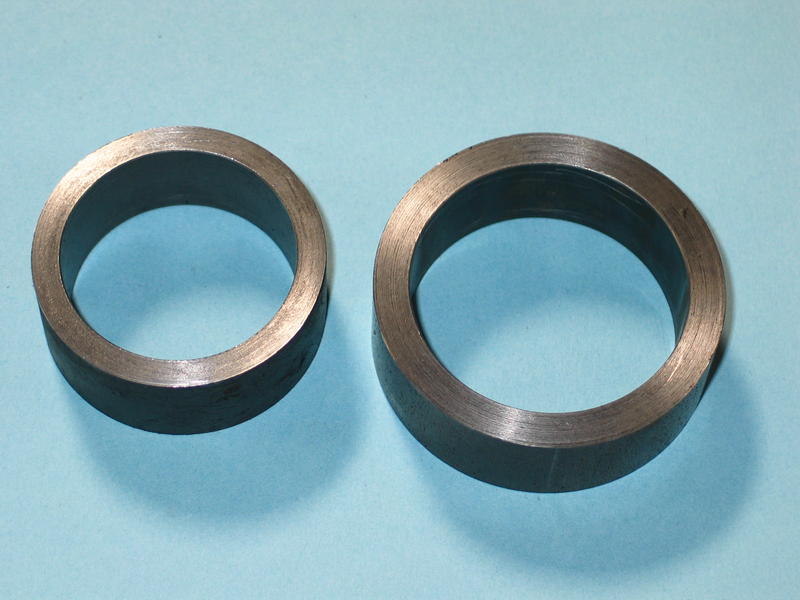

You'll be happy with the swap. While this housing will allow you to use heavier internal parts, the external parts of the ProRock 44 housing are also a huge improvement over stock. The PR44 has brackets that are 50% thicker than stock and don't need reinforcing. Since you have a 3" lifted Jeep, you'll want to use the 'Unlimited' housing option. The Unlimited housing has a corrected pinion angle to allow you to go back to stock caster and get get a better, no vibration, driveshaft angle. All ProRock 44s have 3" diameter axle tubes. The standard 3" tubes are over twice as strong as the factory 2-1/2" tube and the Unlimited uses an even stronger 1/2" wall tube (nearly 3 times stronger than stock). We have our own unique end forgings (the 'C') and they are massive(check the pic). The PR44 also provides better ground clearance.
OK, enough of the features and benefits. To make the swap with a D30, you'll need to reuse your steering knuckles and brakes. You can also re-use your outer axle shafts but many customers are changing to RCVs when they do a PR44 upgrade. The housings come with ball joints installed and you can choose either the OEM ball joint or our Heavy Duty Dynatrac ball joints.
There are 2 basic housing versions for you to consider: conventional diff or factory Tru-Loc electric. The conventional housing will allow you to use any standard 44 style differential such as a 30 sp ARB or a Detroit Locker. The Tru-Loc housing will only accept the factory electric locker (called a Tru-Loc) or the 35 spline ARB replacement. If you use the electric locker you can use factory Rubicon axle shafts. If you use the 35 sp ARB you'll need to use the 35 sp RCV shafts. Keep in mind that the 35 spline axle shaft is only the larger 1.5" 35 spline diameter for the last 5" of the shaft and offers no improvement in strength over a 30 spline shaft.
You may need to get your driveshaft shortened but that depends on your lift and other mods you may have made.
