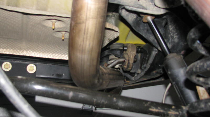

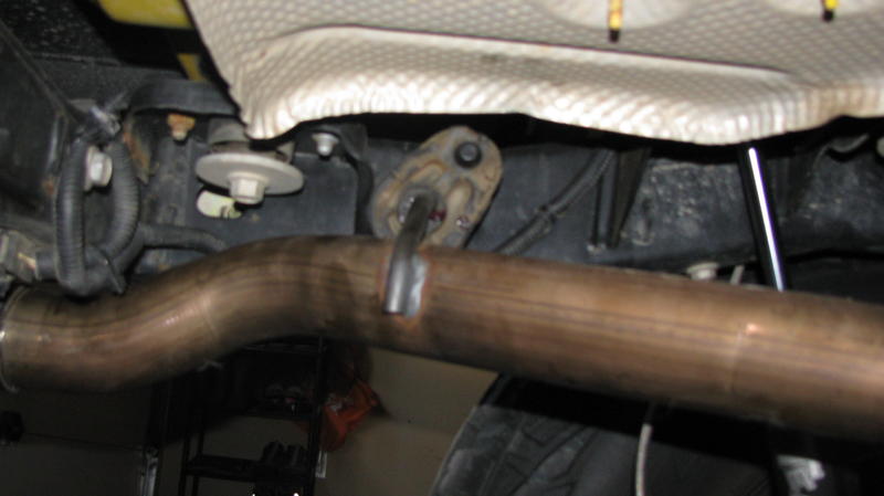

It is hard to take pics underneath but here are a few.

With an additional 1" of bump stop below the tera-flex lower bumpstop I am still hitting the trac-bar against the crossover pipe before totally squishing the stock yellow jouncer. The trac-bar then pushes the exhaust into the bottom of the tub and the exhaust tip into the bumper.
I tried to pull the entire exhaust towards the rear of the Jeep to get the crossover lined up with the trac-bar for clearance but it is not enough. If my jeep was stock there would probably be no issue.

The crossover looks to be in the right place directly above the axle, if the trac-bar mounted lower in the stock position there would probably not be any conflict.
Do you guys have access to a 4 dr jk with the tera-flex axle side trac-bar bracket?
