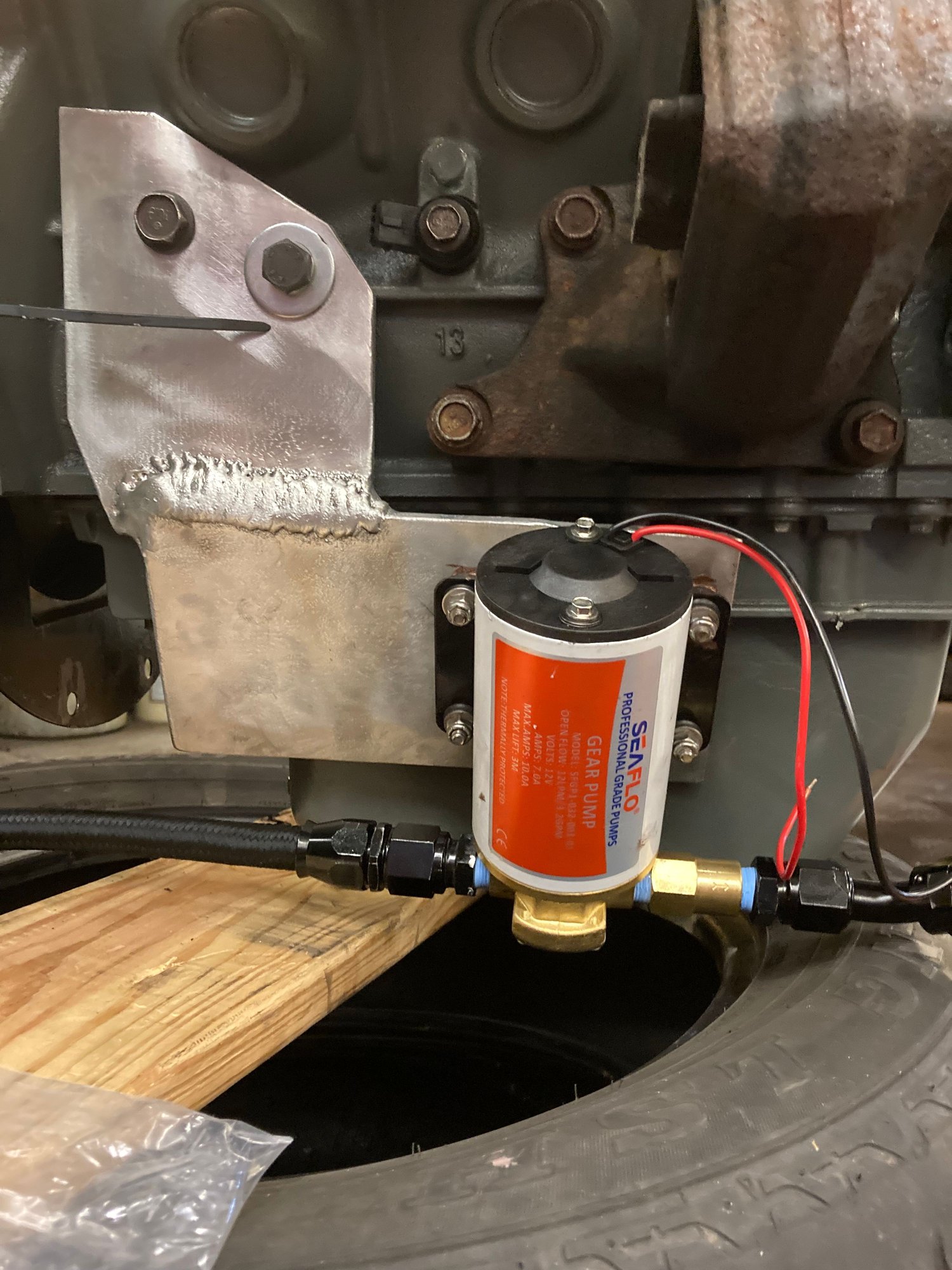

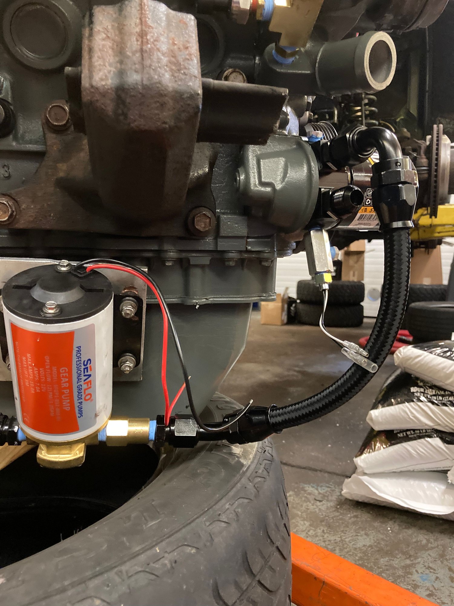

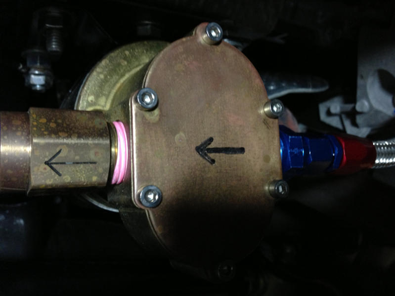

It's not really a can. It's the armature and motor body of a 12v electric pump, about 3.5 inches in diameter and 5 inches tall. The brass pump adds another 1.25 inches and contains two helical cut gears.
It takes about 5-10 seconds of running to ensure the oil filter and oil galleys are full. As back pressure builds, you hear the pitch of the pump's running sound change. Then switch the pump off and start the engine with no ticking, tapping, or clattering!
I bought the pump on EBay for about $150. It's very stout and normally used in marine applications. I made the oil pickup from a custom tee and Fumoto valve, added an inline check valve after the pump, plumbed it with Earl's lines and fittings, and hooked it up to an oil filter sandwich from Glow Gauges. Hardest part was designing a stainless steel mounting bracket which spans from two of the engine mount bolts to three 6mm oil pan studs (custom). But it is VERY SOLID and everything can be removed in 30 minutes to return to stock, right down to the oil pan screws and drain bolt.
Besides the pump, the filter sandwich was about $30, the plumbing about $100, and the custom bracket mount ended up at about $90 ( it took two tries for a local shop to fabricate it correctly).
The Fumoto valve and extension added a bit more cost, but the biggest challenge and fun was designing and building custom pieces.

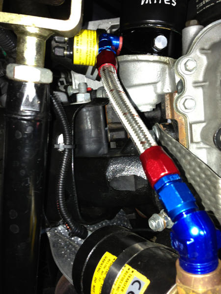

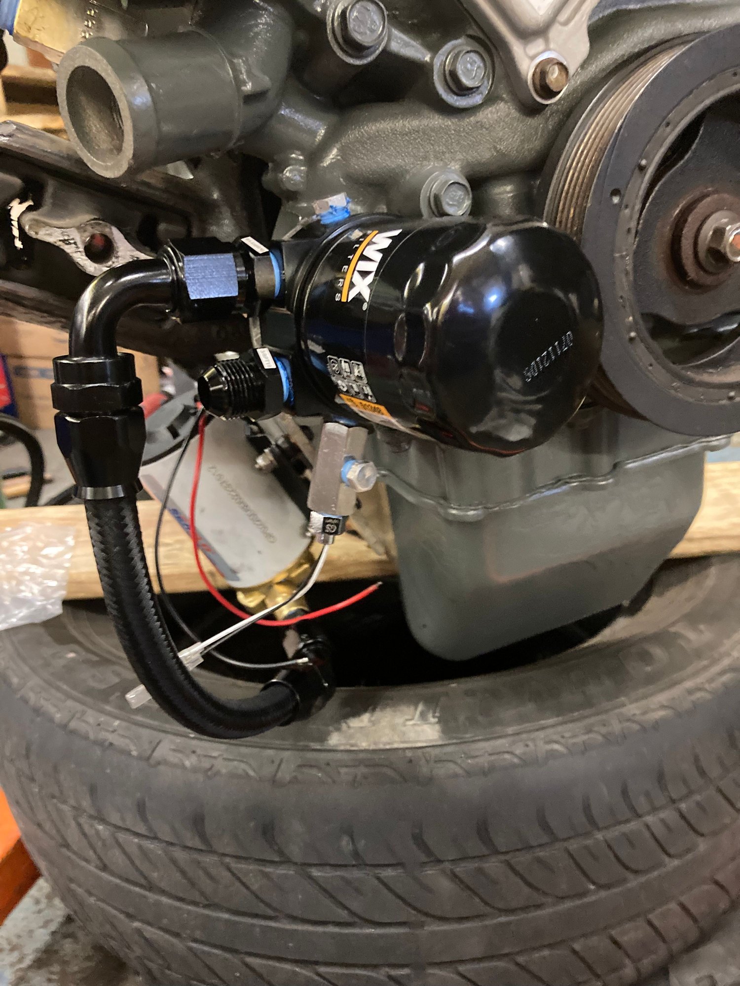

So I’m not sure which side of the sandwich plate adapter to tie the line for the engine pre-lube oiler . Is it the In or Out port I don’t want to freeze up my internal oil pump by using the wrong port
