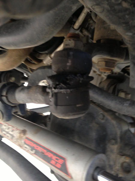

So I got the part from auto zone but I can't get the old one off. I lessened the nut on top of the end link boot but it won't come down off the part it's bolted to. Even with a crow bar.
Do I need to loosen the 2 bolts on the drag link that clamps the threads in place first?
You can see the nut in this pic. The one on top is the one I loosened (not in this pic though) but It won't come off.

You need a tie rod end tool or a pickle-fork. That upper one might be easier to get a pickle-fork on.
Rob

+1 there is a tool that clamps around the the attachment and pushes it through
