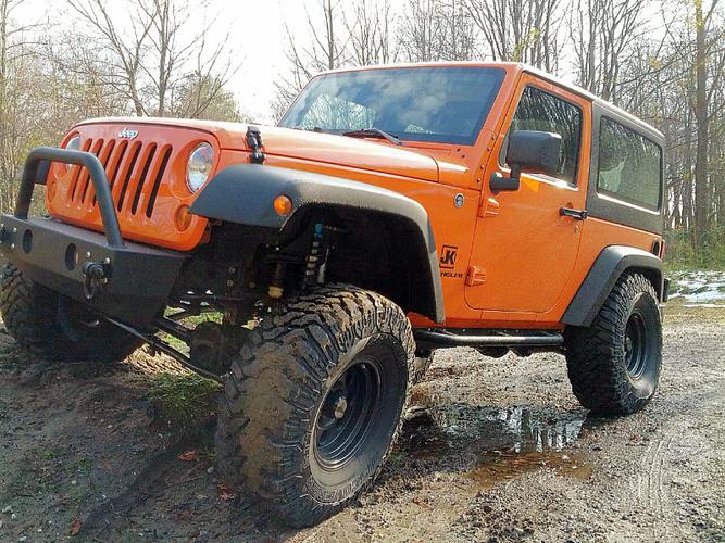

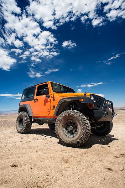

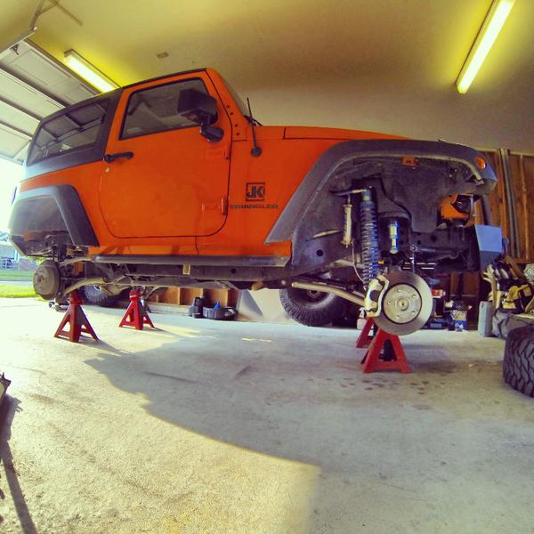

I'm running the Evo bolt on coilovers with 35s. Took some tweaking to get the spring rates right but it rides quite smooth now.

Sweet! Yeah looks good! Why does it look like you have no flex at all?
Haha doesn't look like a whole lot in the pic to make it flex.
Haha that and the front sway bar was still connected.
