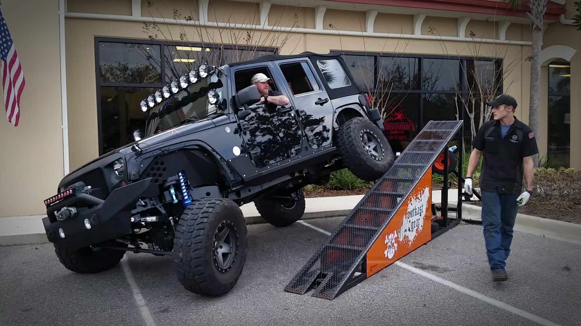

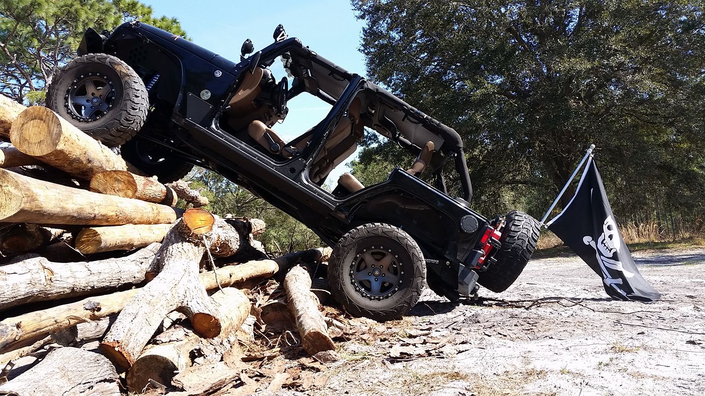

ID:	667058Click image for larger version
I'm still waiting on my fenders from ACE.
