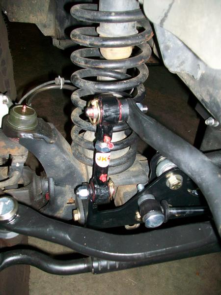

I just finished installing the drag link flip kit last week. I've had the kit in my garage for over a year but have just now had time to install it. The one I purchased had sway bar link risers which I did not want to use originally, but decided to use eventually. Without the risers, my JKS links would not work. You have the sway bar link pin on the wrong side of the bracket, and if it's on the inside, it is impossible to add the link. I suppose EVO can suggest some sway bar links that will work with the setup, and I'd be interested in that information as well. You can look at my pics to see how the sway bar pin orientation is supposed to be.
I am happy so far with my kit even though I had to do some modifications to get the kit to work (notch out of my EVO c gusset on the driver's side, notch out of the driver's side link riser bracket to avoid tie rod interference, and notch out of passenger side sway bar riser bracket to allow proper link travel).
Good luck getting it sorted out!
Micah

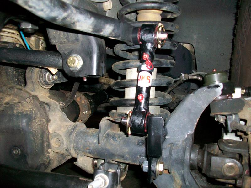

Here's a pic of mine if it helps.
