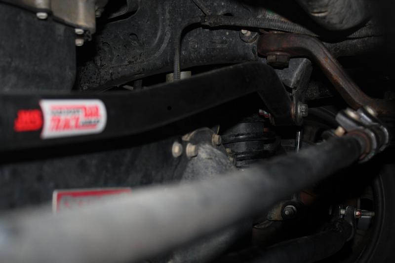

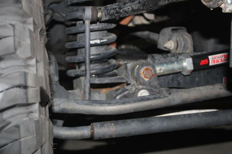

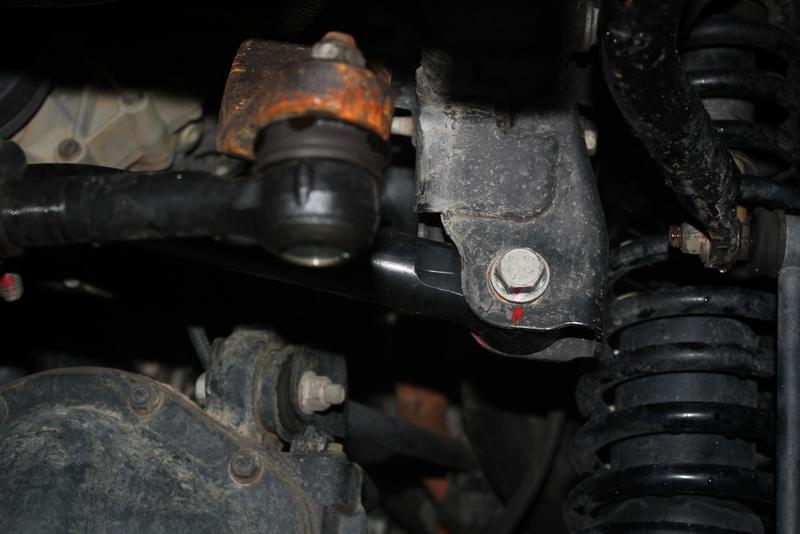

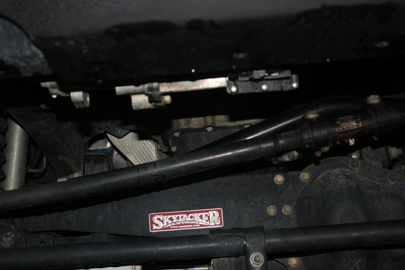

fwiw, plus I said I would add this:
both the trackbar and the drag link both showed 7 degrees - all in all pretty parallel
now the pics, starting from passenger side to driver side:
the relocation bracket I was referring to:
showing the tb and the drag link from the side looking from passenger to driver side:
showing them from the front:
showing tb attached (what looks to be stock attachment) frame side:
