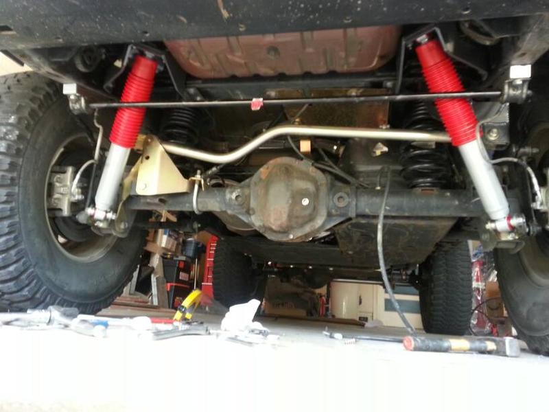

I installed the synergy mounts. I think they are a great option but there are things that have to be changed to make them work.
I'm using Metalcloak lower mounts which raise the shock almost 3".
Other required mods:
Non factory exhaust (I think this is a good thing)
Space sway bar back and down to clear shocks. (worked for me because of the non factory exhaust)
Can't use stock sway bar links. I'm not sure what links I have, I flipped them and used a special bolt that I had laying around.
Tailpipe needs to be tweaked so it's not so close to shock boot. The pipe was made before I installed the upper brackets.
Sent from my d2lte using Tapatalk

I usually try to maximize my travel and I would have preferred to run 12" travel shocks but I wasn't ready to cut holes in the floor or reduce the already crappy ground clearance of the rear shocks.
