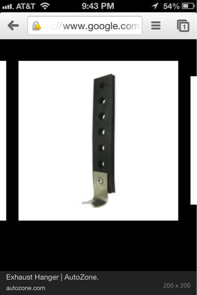

Nah just some clamps and pipe from autozone. Easiest thing to do would be 90 deg elbow, new muffler and a length of pipe out the side in the stock rear location. Then get one of these hangers and an extra clamp and attach it to the body mount on back right corner. Get it done under $100
