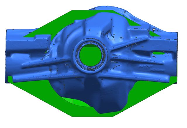

There has been some great info posted here and I really appreciate the comments.
In reference to clearance, I've posted a pic below. This very clearly shows the difference between our PR60 and a fabbed housing.
There is no question that a 9" gear is very strong, at the same time it also has some weaknesses that make it a less than perfect choice for off road use. In a front axle, to build it as strong as a 60 you'll need a True-Hi9. Aside from being very strong it's also very expensive. Also, like the PR60, it's really only needed once you get over a 37" tire. Forgetting about axle shafts for a moment- how many front Rubi 44 gear sets have we seen broken? Ever? Any size tire, any weight? The answer is close to zero. A PR 44 with good shafts is enough for 37's and down and a Hybrid 44/60 will survive much larger tires yet. A PR60 is pretty much good for anything but the competition rock bouncer and those guys break EVERYTHING.
In a rear axle one of the major differences is ground clearance. Even in LP to LP applications, the 60 has an edge. I know some will argue, but to me, just the drive shaft angle is huge difference. A 9" has the pinion center line at 2.25" below the axle center line. A Dana 60 pinion is 1.125" below the axle center line. An 1-1/8" may not sound like much but it makes a huge difference in a rock machine. Additionally, the 9" third member has a ring of bolts that act like a shovel and a pinion guard is a must-have item. Keep in mind that a large reason that the 9" is so popular with racers has been the ability to quickly change ratios for different tracks. This isn't a concern in our off road world. Going to a HP 9" rear, again, requires a True-Hi9 but results with this combination haven't been consistently good in a DD application.
To me personally, even taking off my Dynatrac hat, I find the ground clearance of the PR to be its biggest asset. I've been very lucky and have wheeled in many different areas with my Jeeps. I've seen the difference, first hand, that the clearance and housing design makes when wheeling in nearly any location.
