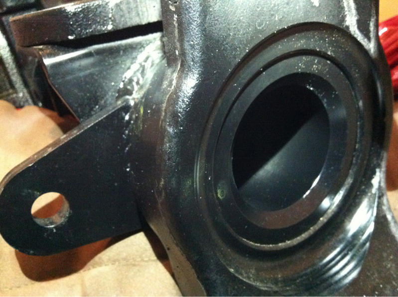

I will be installing my prorock next month but I can tell you this so far.
I wanted a heavy duty, rock solid, new axle housing, and not a used junk yard axle housing. I felt like if I was gonna drop 20k on a jeep why would I put a junk yard take off axle as the main drivetrain component. I wanted a direct bolt on replacement to my d30.
I can tell you that this housing is built with extreme care and is high quality. The welds look great, the C's are MASSIVE, the tubes are thicker then I ever imagined, the pumpkin is reinforced and stout. I do not regret spending the extra cash for the prorock 44. I'd do it again in a second no question about it.

Here's a pic to help show how thick the tubes
