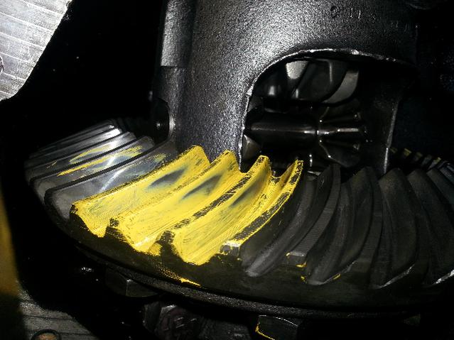

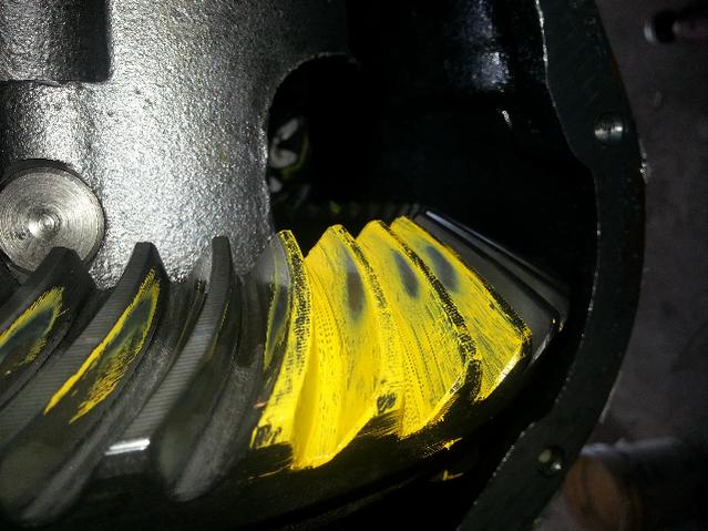

Well I've been getting parts ready for my regear. I checked the factory settings. Back lash was .001" off at .009". Total torque to rotate was .010". According to all data at work, the total should be .010 to .020" plus at least an extra .007" to rotate with carrier installed and axles removed. Here is picture of the gear pattern from the factory with drag applied, the gears have 13,000 miles on them and im not sure if im liking that pattern when looking at the coast since (since they are not brand new)

And of course I was sent the wrong gear set so I put everything back together, installed a new crush sleeve and set the preload slighty tighter and used lock tight on the original pinion nut. Does any one have any feed back on this? Or am I just freaking myself out?

It's not perfect, but I think you are freaking yourself out a little bit. You mentioned your new gear set was wrong so I take you you'll be getting them exchanged for the correct set?
