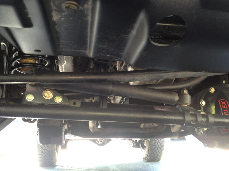

The Synergy bracket is a cheap easy install. Just read the instructions online since they don't provide any, also buy extra washers (first pic) or the stock unit won't fit. They don't provide enough washers as well... Also the first pic has the bolts installed backwards, they should be facing outward (damn you Synergy for not providing instructions). It does do a great job of moving it up out of the way (second pic).

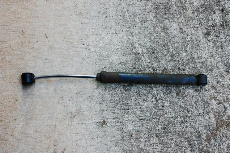

Run the stock one. If you're going off-road, relocate it. I recommend the Wood's/Dominion Off-road kit. Eventually the stock one will fail ... perhaps by just losing pressure, or perhaps like this if you play hard ...
Name:	Bent Jeep Steering Stabilizer, Jul 09, 0234.jpg
At that time replace it with a beefier one. I recommend the Teraflex. It's about 50% heavier and is unlikely to end up like the lightweight stock one. Regardless, as mentioned, a properly set-up Jeep runs fine without a steering stabilizer. Many of us have run for a period of time without them--as did I when I bent mine. Dual stabilizers are for pick-up truck drivers who want to look cool at the mall.
