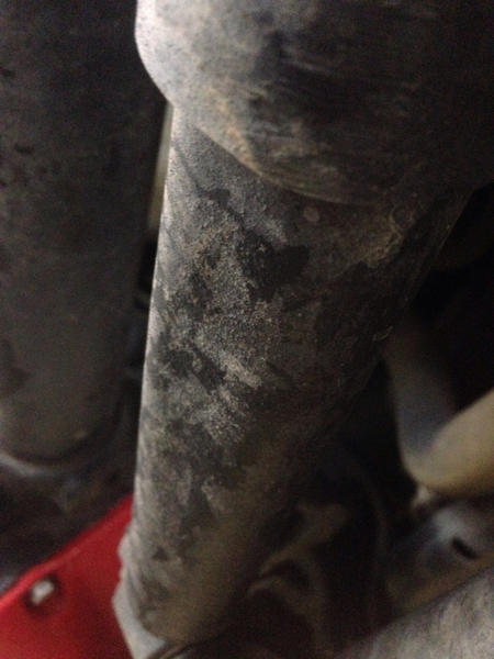

Mines got a nice bend in the body
Sent from my Obama phone using JK-Forum

How do u know if it's bad? Aka the oem one?
