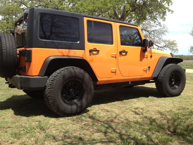

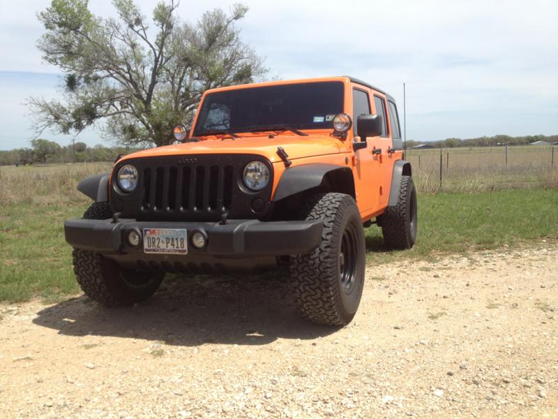

And, here are the cut fenders with 35's..
Bullfrog

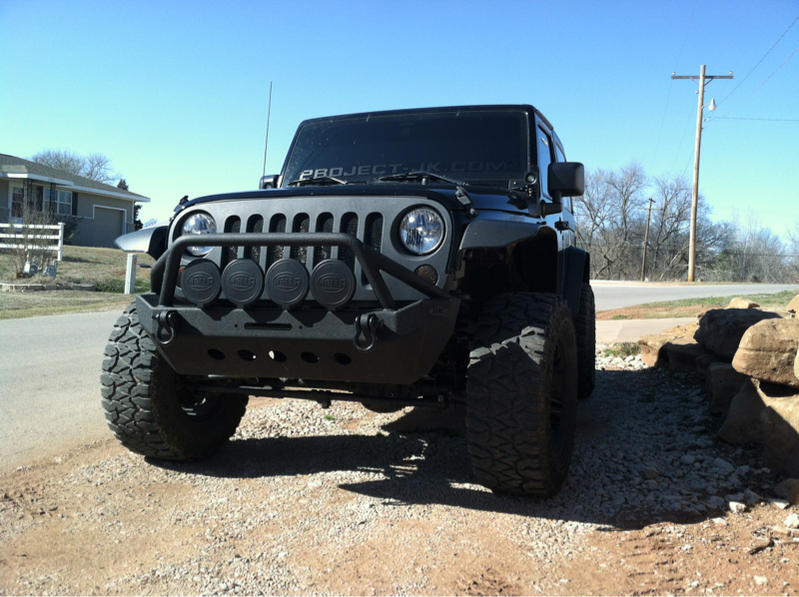

On the jeep. No regrets. Cut big and go down if needed, you can always cut te second time but can't add on

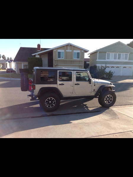

Cut fenders, 3 inch lift on 37's. like everyone else has said, the 1st cut is the hardest.
