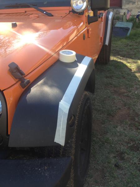

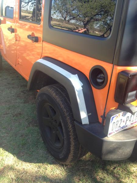

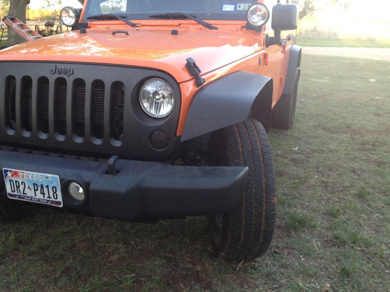

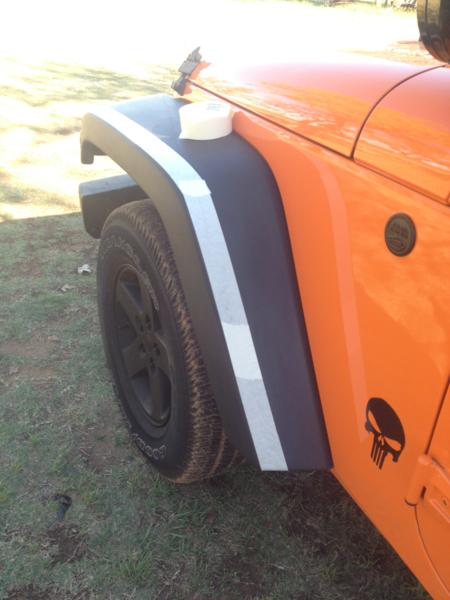

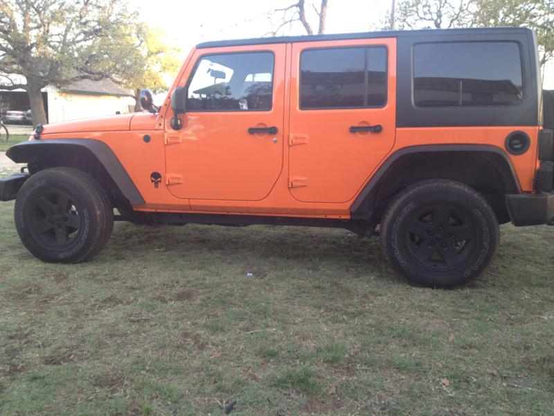

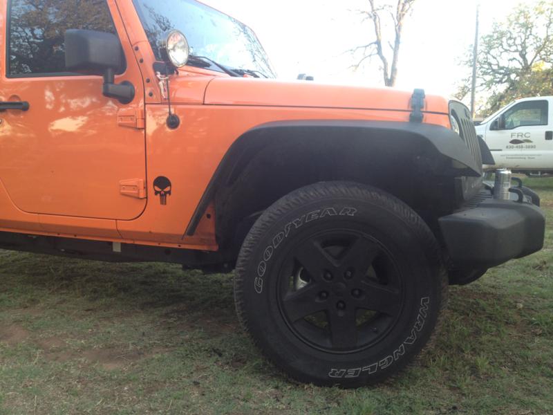

I actually cut mine last night in anticipation of installing my 35's today. My 4" Lift goes on Tuesday but I had to make it all work logistically..
It does look funny with the stock tires on but if you are going bigger, it is the way to go.. I am sitting in Discount Tires waiting for my 35's to go on.. ;-)
Here is a link to an awesome video if you're going to do it... I also kept my rear fender well liners, but most just chunk them and paint the inside of the fender well... I can give you the details if you want to keep them, I think it looks better with them..
http://youtu.be/EppDwS34sXs Here are pics of mine last night...

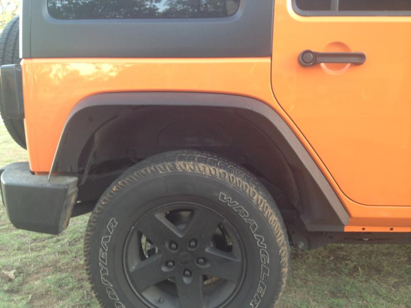

The Green Monster's Avatar
Posts: 95
From: Killen, Alabama

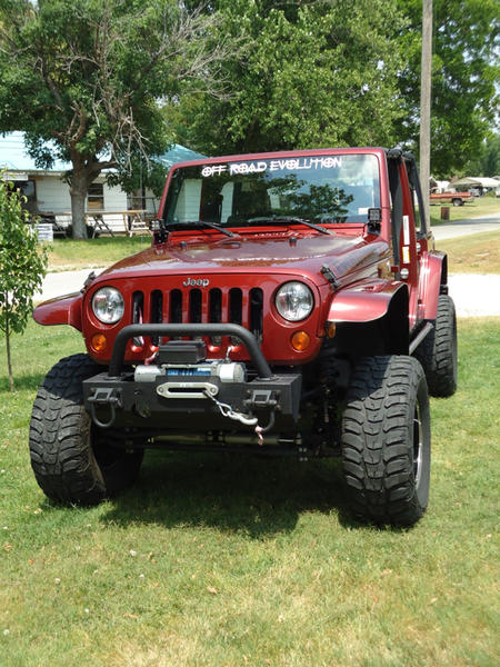

That is the main video I used when I did mine. I have no regrets with my fenders. My front liners, however, don't look like I want them to, but they are acceptable.
These were taken before I sprayed the fender wells flat black. They look much better after the paint.
Old Apr 5, 2013 | 10:04 AM
SebasCbass's Avatar
Posts: 379
From: Dumont, New Jersey
Jeep looks great! You did an awesome job cutting the fenders

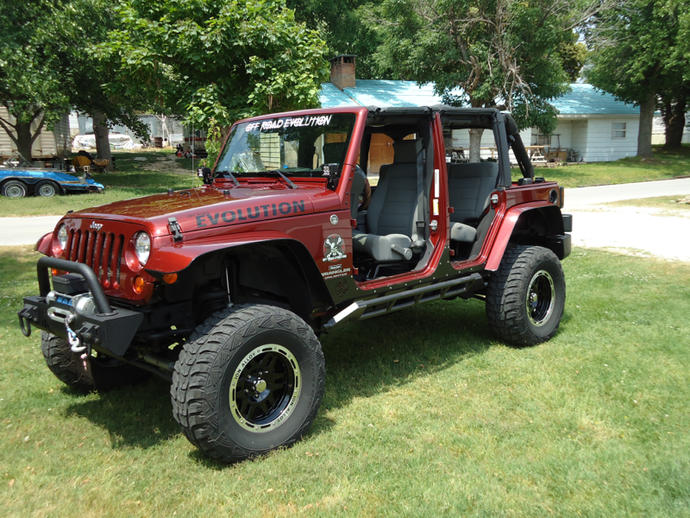

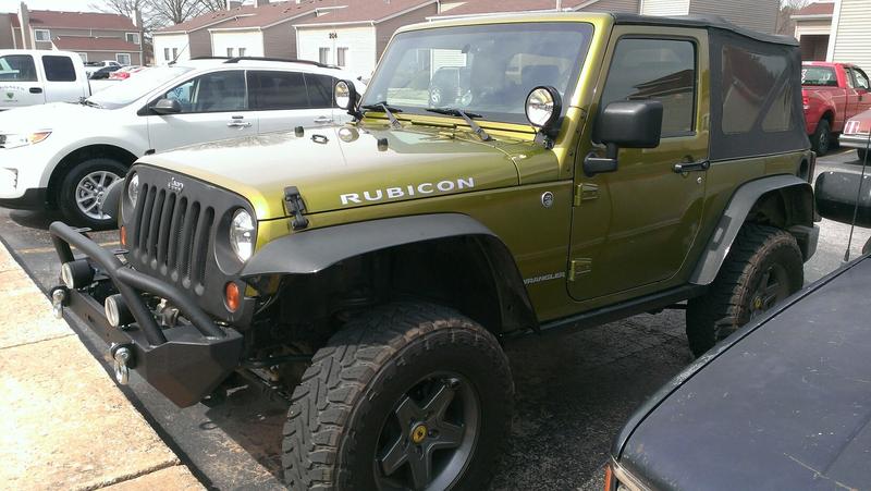

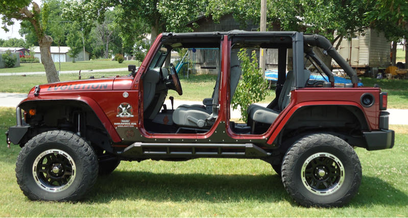

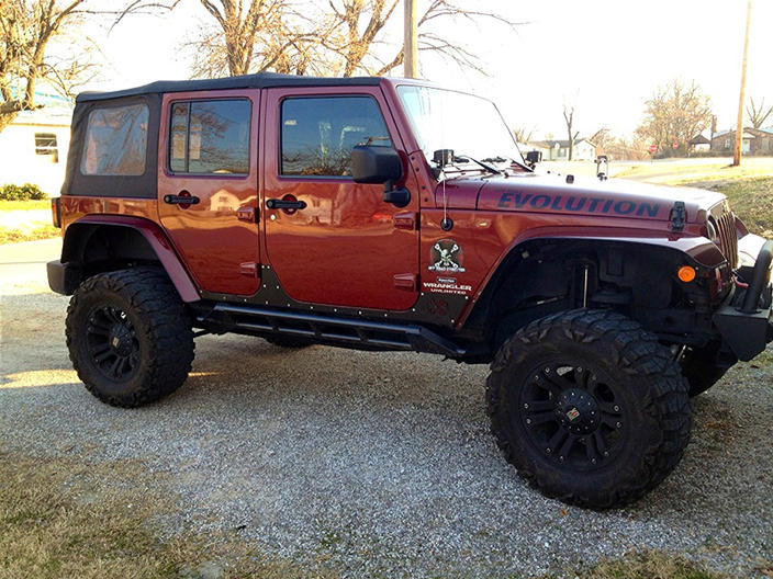

I did mine last year and don't regret it at all.
Looks great!!
