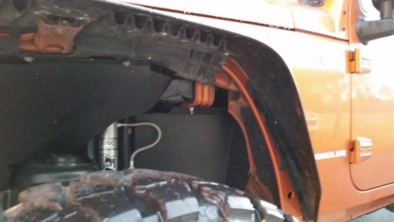

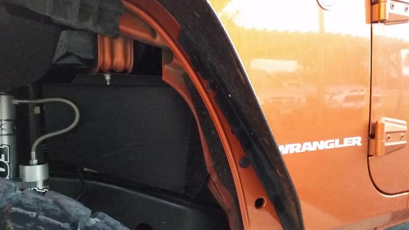

I did exactly what you are talking about doing. I bought the MC liners bc i dont like the gaps that are in the factory liner after cutting the fenders. The only thing with the MC liners is that you have to drill 2 holes in each side in oder to bolt the small support piece you are worried about. Also they do not provide bolts for the small support piece so you will have to go to a local hardware store to pick some up.
When i get home tonight i will take some pictures of what i am talking about and post them up in the morning.

My fender mount over where the holes need to be drilled. So im guess i can just drill the holes, mount the liner with low profile screw heads, then just put my fender over it and just tighten it down over those screws.....
Here u can see the 2 bolts i used, and the top one interfered with the fender so i just trimed the fender.

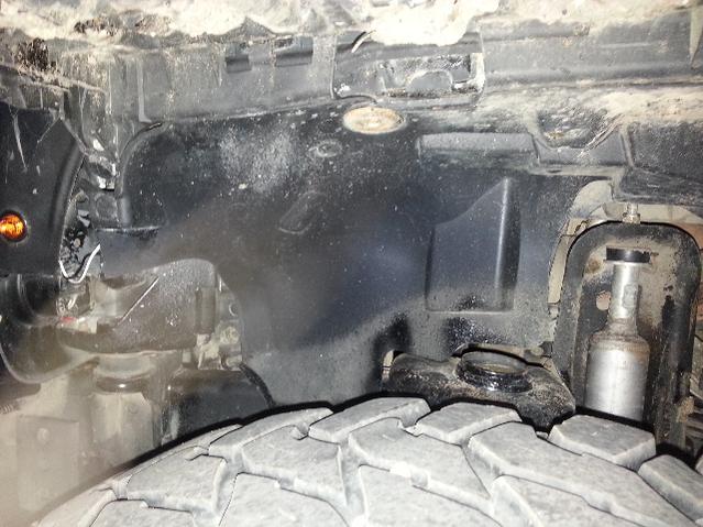

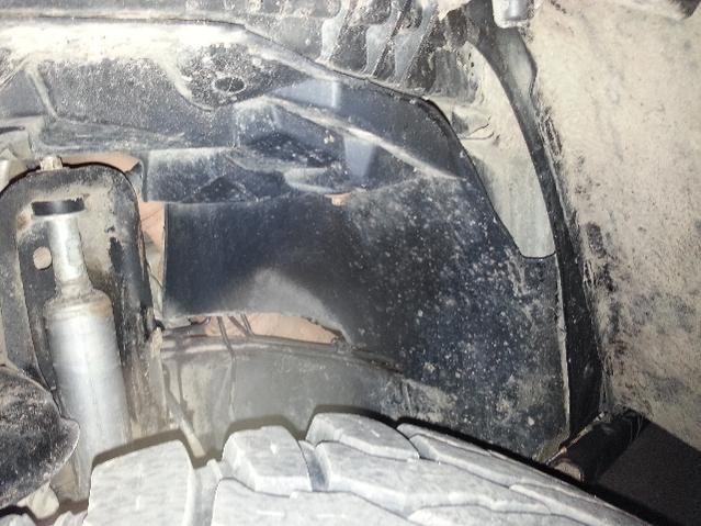

These are mine. Mine cover everything.
Well close to it.

You can see where i bolted mine and tucked it in. You could also bolt it.
