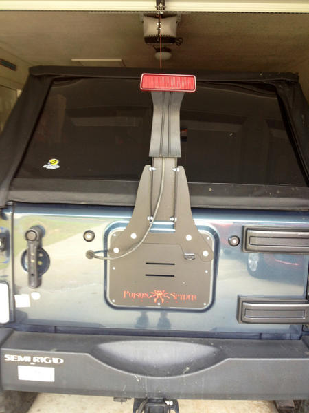

Do a search for a tramp stamp...lots of companies make them. They will cover the openings in the tailgate. I'm running the Poison Spyder one with the Teraflex 3rd brake light.

If you opted to not install the light bracket, would there be a hole where the light cable comes out?
Thanks for posting the link.
Yea there will be a hole there and where the bump stops are. You can run to the hardware store and pick up some rubber/ plastic grommets or go the route I did and go with UFOs from Vector Offroad.

I just looked it up. This will work. Do you need to cut the 3rd light cable?
Old May 6, 2012 | 02:17 AM
Doc Highway's Avatar
Posts: 112
From: Newfoundland, Canada
You do not need to cut the cable. If you remove the plastic grill on the inside of your tailgate you will find a connector that you can unplug. This cable runs through the grommet hole you will be plugging if you remove your spare carrier. You should save this is you plan on a reinstall or to add a third brake light after as you can just plug it back in again. There are some good write-up on this on the forum. I believe you may find it if you search third brake light/license plate delete/mount. I can't do it now, but if I get a chance later I will post the link. Good luck.
