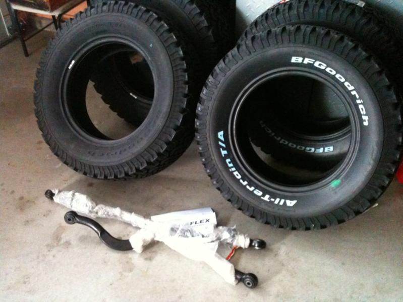

Ok so i just picked up a set of 275/70/18 bfg a/t. I feel like a little kid in Christmas. I also got teraflex track bars front and rear. Now should I go with black letters or white letters? I'm powder coating my stock 18's. And I have a steel blue jku. And another question how much longer do I make my track bars for my lift? I have the emu hd 2" with no extra weight. It looks like I got a lot more than 2".

Definitely black out, white letters in.

Yea I was leaning more to black. What about the track bars?

Measure the distance between ur tire and frame on both sides, u will see which way of needs to go to be centered. Install the new bar with that distance added or subtracted from the lengh of the original bar. May take a time or 2 to get of exactly right but I don't know of a exact measure for u, each jeep will be a touch different.

You might have to center your steering wheel after. Also, lettering in!
