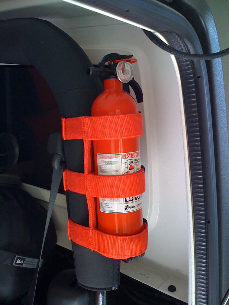

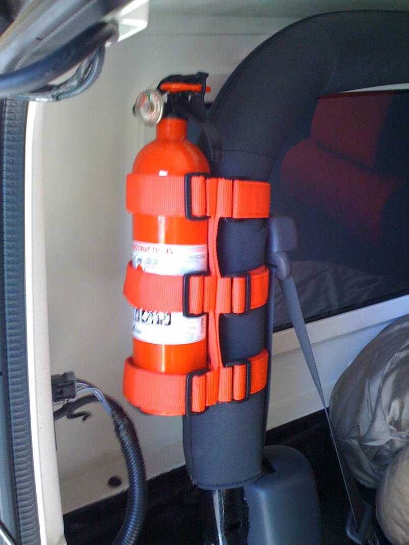

I have the rugged ridge holders with some kiddie fire extinguishers from Target I really like them! They look great with the seat covers as well!

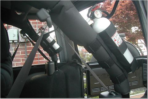

Here's where I put mine (I can get you a close-up if you need):

Those are both good ideas. ElovesC, how does your mount hold up off road? I'm wondering if the straps will slide or bang around when things get a little bumpy!

I have not had any problems with them. They have 3 velcro straps and I tightened them down really well!

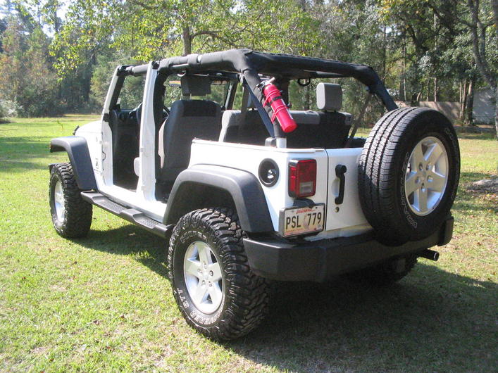

I just cut some little notches in the stock holder and put two zipties aroun it to the rollbar, Added two of those small ball bungies to stabilize and hold the ext in place. It doesn't move and is still easy to get off plus its cheap , bungies pack of 4 or 6 , can't remember ,$3 and zipties a few cents.

Not a close-up but thats where it is
