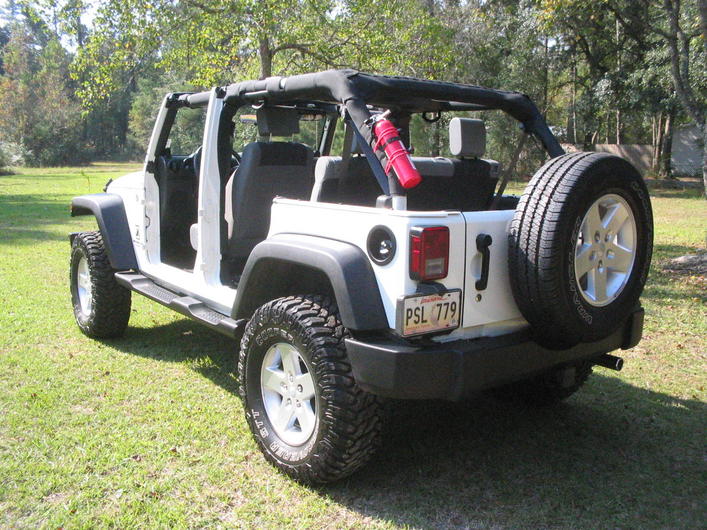

Originally Posted by mkjeep
I just cut some little notches in the stock holder and put two zipties aroun it to the rollbar, Added two of those small ball bungies to stabilize and hold the ext in place. It doesn't move and is still easy to get off plus its cheap , bungies pack of 4 or 6 , can't remember ,$3 and zipties a few cents.
Attachment 13313
Not a close-up but thats where it is
good idea, I'm gonna try that method.....

It's cheap, and I don't find it any harder or slower to remove than if I had velcro straps.

good mod !!

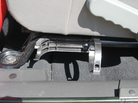

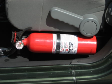

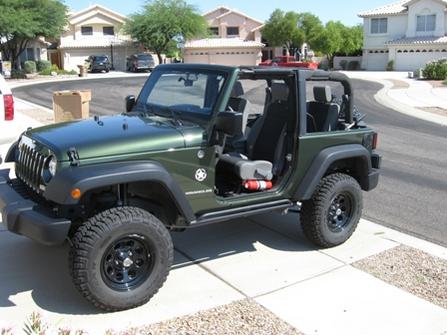

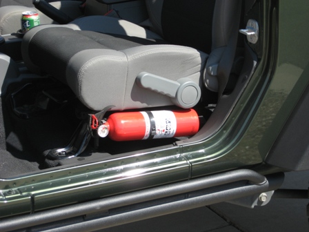

Default Quick access
I followed a write up posted here in this forum. It was simple. I bought the fire extinguisher from Home Depot and mounted the bracket directly to the seat frame. It is not in the way and has held up great for the last 4-5 months.
